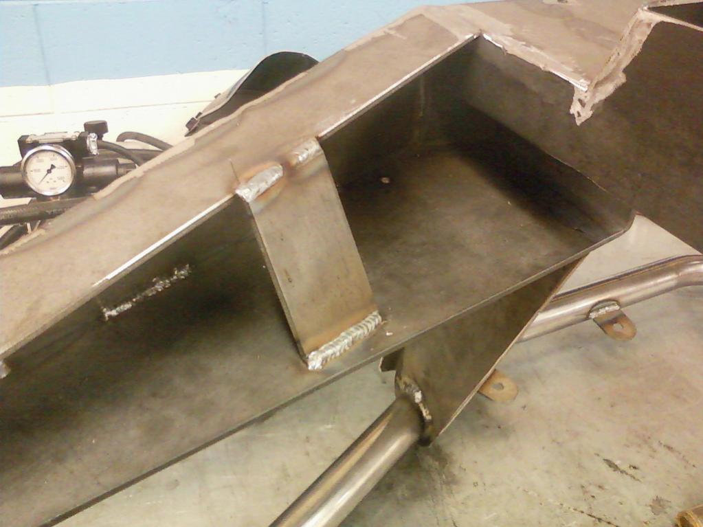

You did extremely well on that project. I worked as Quality Director in a small metals fab shop that built things like the front bumper for the Bradley Fighting Machine, cabinet controls racks for Navy ships and subs, and a variety of other projects as they were in their final death spiral after having been the major defense department contractor in Johnstown PA before they decided to go to commercial cheap mass produced stuff then went totally out of business and locked the doors. I escaped just before they folded as the business base had evaporated on them.
Anyway, I saw firsthand as a huge variety of items were cut/formed/welded/painted/and inspected.
Your welding certainly improved. The overall design is rather robust. A formed assembly is quite strong. I would like to offer a comment regarding the braces.
I think it would be an improvement to have rotated them 90 degrees and have them be an internal gusset within the bumper rather than the way they are oriented across the opening. If you understand what I mean, they would provide much more support.

Thanks for the compliments. Yeah you're right about that brace, the moment of inertia would have been way better had I rotated it. The brace was more of an afterthought than a design feature though, I think it would be plenty strong without it.
