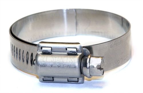

If the leak is coming from the hose @ the pump (or not), PLEASE.....get rid of that Cheap A$$ Home Depot hose clamp and get one that is smooth on the inside. You can get them at any auto parts store or online, just look/ask for clamps that are made for silicone hoses. They look like this > Silicone Hose Clamps | Gates Corporation

Water pump weep hole is as dry as can be. Ended up being that cheap hose clamp. It was just what I had on hand at the time. I replaced it with a proper one and the leak is gone. Thanks everyone

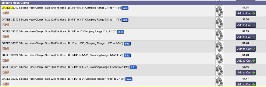

I buy clamps in bulk from a few places, but for example RockAuto has a decent price on Gates clamps (see pic).
Another good brand is ABA /NORMA like > Original-Per Clamp (316ss), Ultimate Garage
