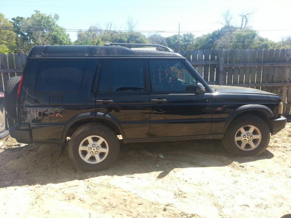

Here it is. I'm not sure if I should just buy this or get some parts. Don't know how much yet but I'm thinking less than 1k.

Buy it for less than 1k and part it out.
The headlights are worth at least 150 a piece on the worst day.
