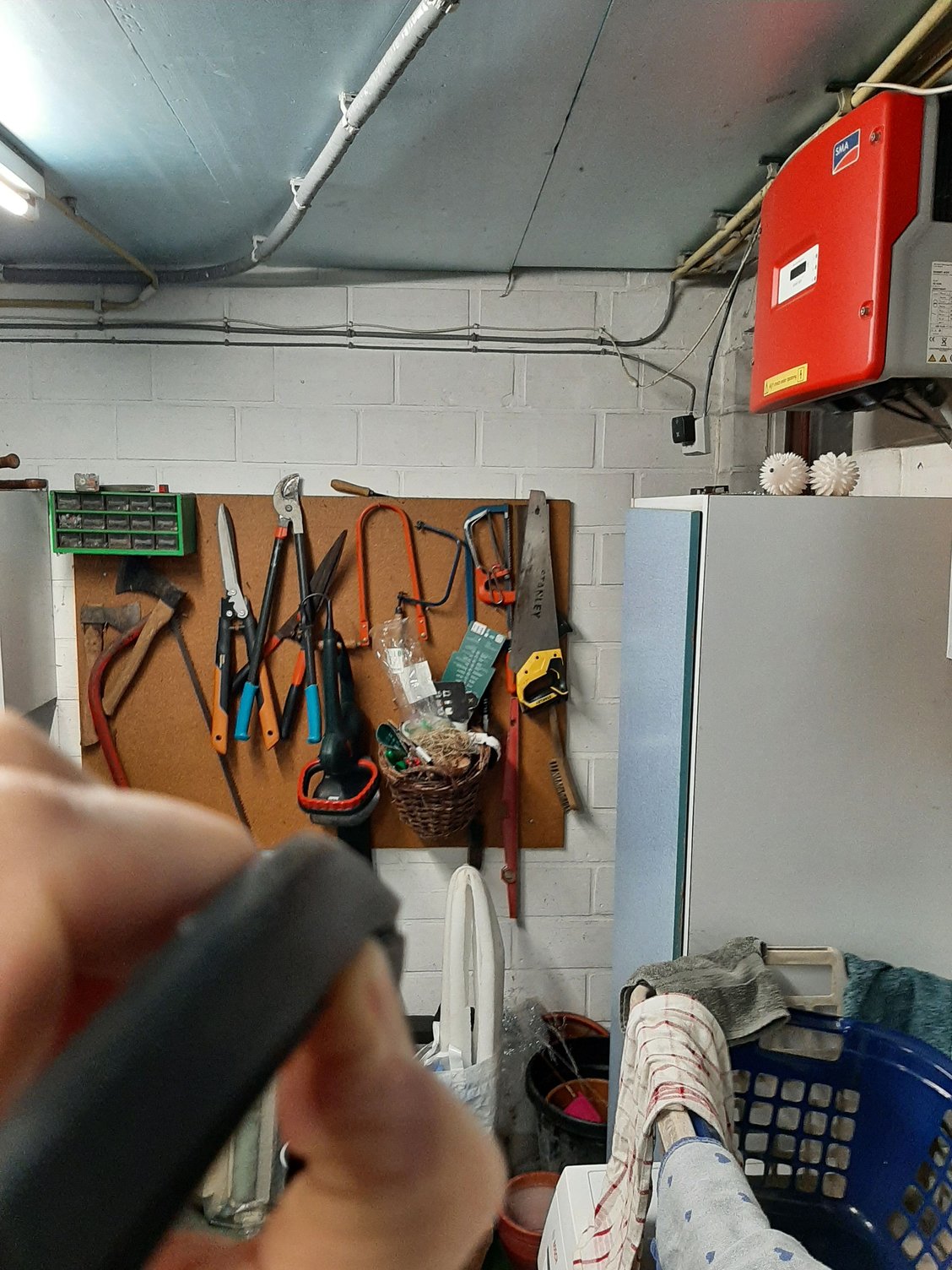

New seal with opstanding one side to the keft

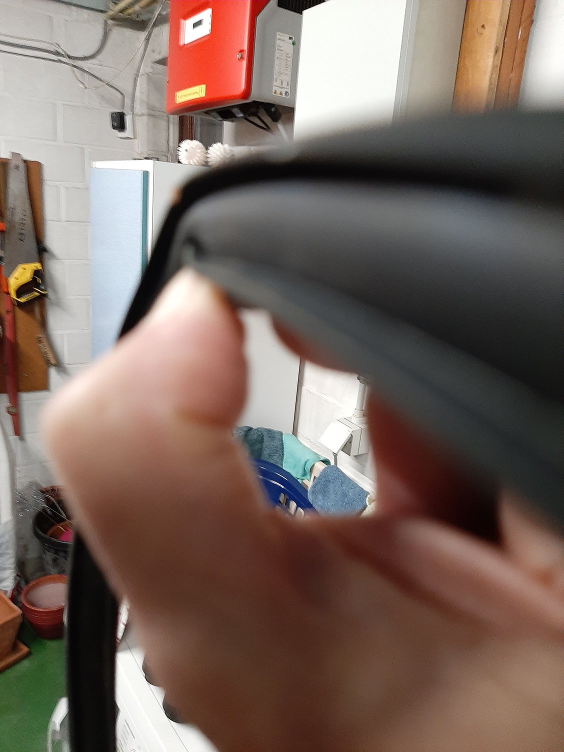

New seal with sloped other side to the right

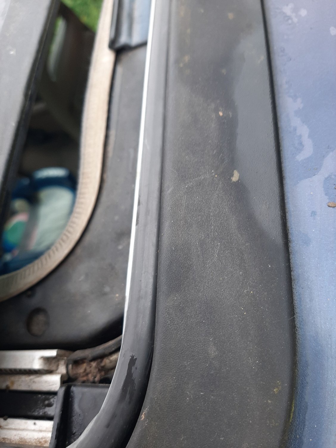

26 year old flattened seal (with sloped side to the roof) But is this the correct position ?
