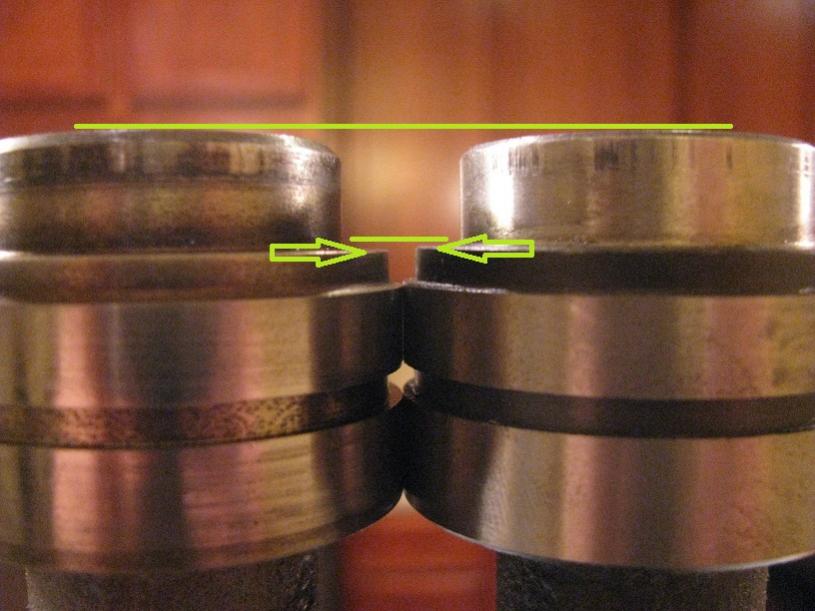

This time, new RIGHT, old LEFT. Brand is Allmakes, manufacturer is unknown. Some of you are already aware of my issues with this new cam. I previously thought it was shorter, causing the gear and itself to clamp down on the thrust plate in between. A non-rotatable cam shaft is of course, bad. However, it turns out the journal is actually too tall or high, as you can see in the picture.

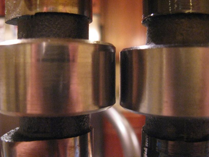

The lower journals appear to be spaced slightly different too. This may not matter.

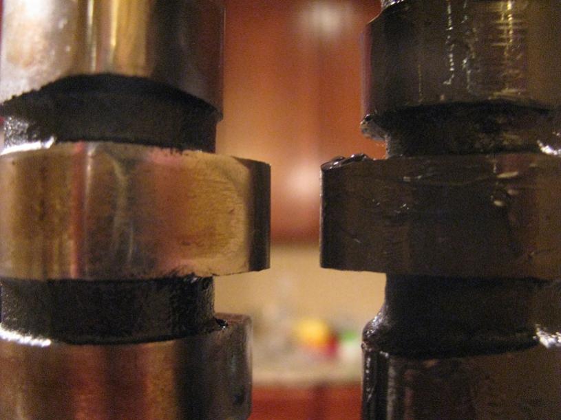

Lobes appear to be spaced the same, thankfully.

If the block is out and has nothing in it (head, etc.), slide the cam in, install as normal. Now check all the clearance, see if it binds or has any interference. I (we) would definitely like to know...

All other tolerances and signs of quality look good upon installation. I'm not exactly using precision lasers here, but moving it around felt the same as original. Obviously that was until the gear was on.
