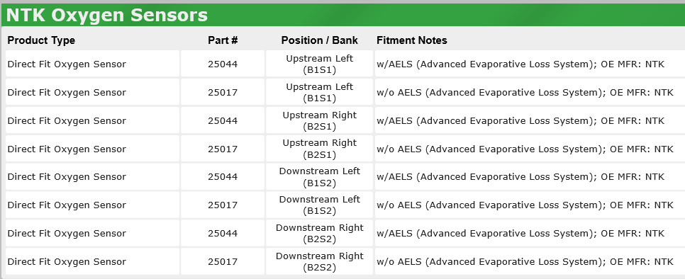

The o2 sensor on amazon is a NTK25044. Rock auto lists that number for rovers with AEL and NTK25017 for Rovers with out AEL. Can anyone confirm that?

Just a headsup, before you order the NTK O2 Sensors (either #25044 or #25017) you will need to know what Evap/Emissions you have.
Very simple to ID > https://www.roverparts.com/TechTips/...ons_system.cfm
OR > https://www.roverparts.com/resources...ssions-system/
And 100% get the NTK O2's!!!!

It's a 96, no AEL. Man, Ocarlo you've got all the heavy hitters here tonight! NTK 25017, all four. AELS came out the second half of 97, I know this because I had an early 97 without AEL, roundish vapor can that stood straight up.
