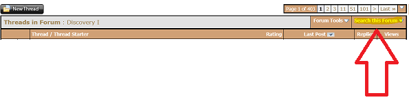

RE: How to SEARCH in the DI section(or any section), have a look at the 1st pic.
