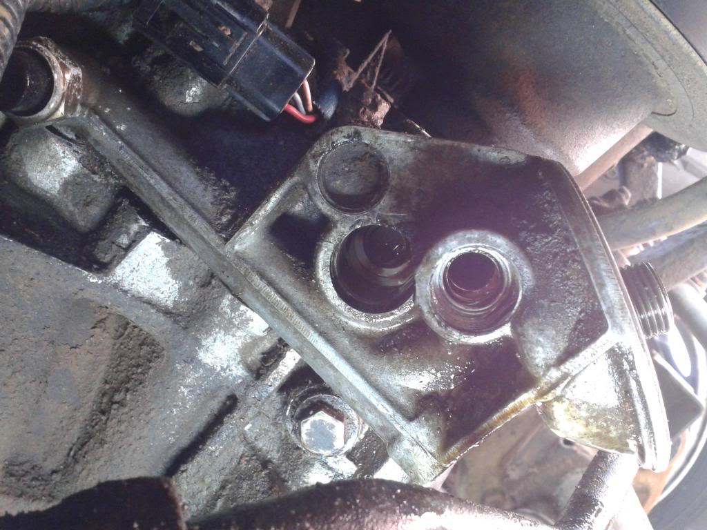

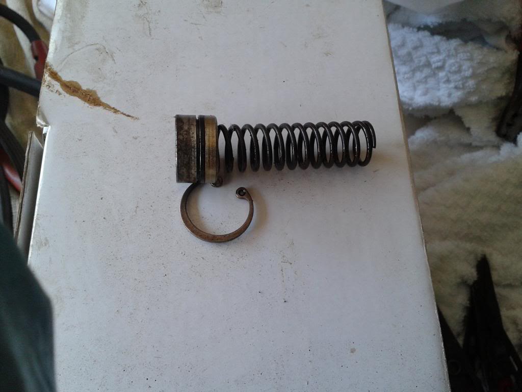

Found my leak, there is a small disc held in with a snap ring just above the oil filter by the oil line
Anyone know what it is what's behind it? O ring? Would like to know before removing the oil line to access it

Originally Posted by TOM R
Found my leak, there is a small disc held in with a snap ring just above the oil filter by the oil line Anyone know what it is what's behind it? O ring? Would like to know before removing the oil line to access it
If we are talking about the same thing, it's the pressure relief valve. Spring loaded.

OK what seals it
OK what seals it
I think there is an o-ring on that plug held in by the snap ring. I think. Maybe.
Guess I need to fix that
Don't misplace the guts. Parts aren't available separately. So I hear.

Hoping oil leak fixed! o ring was shrunk and brittle pain to do, changed o rings on the oil line I had to remove since I had it off
This was a bitch to get back in, insert spring, install cap then pushed cap in and wedged a pair of 3/8" ratchet extensions (6" + 3") between cap and frame to force cap in then it stayed by itself while I reinstalled the snap ring
Used green o rings cause I had em
In bottom pic hole on left is pressure relief, hole on right oil line pic is rotated about 90* counter clockwise
