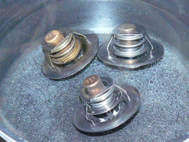

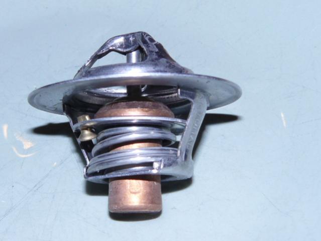

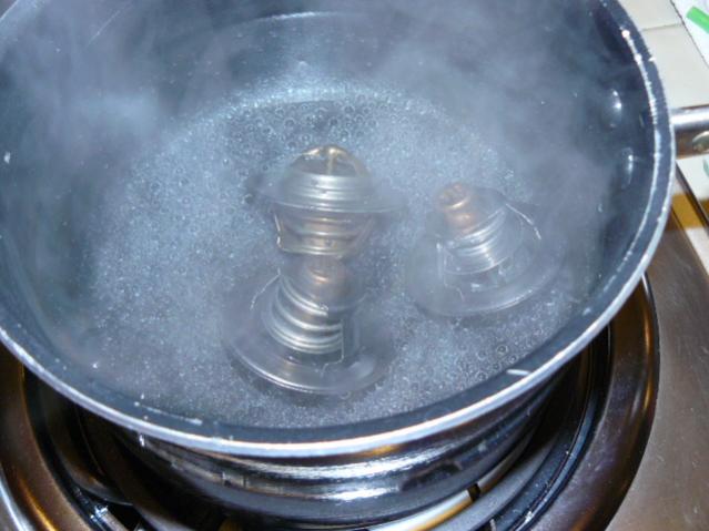

Well, it may be academic, as pump volume will also change by thermostat opening size, a stat does not have "snap" action. See pix of thermostat soup and notices variations in opening percentages. Many guys test a new stat on the stove before installing it, just to be sure.
