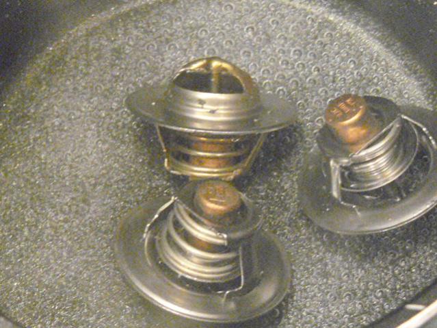

Stat might not be opening when it should, you can test on the stove - pix attached.
