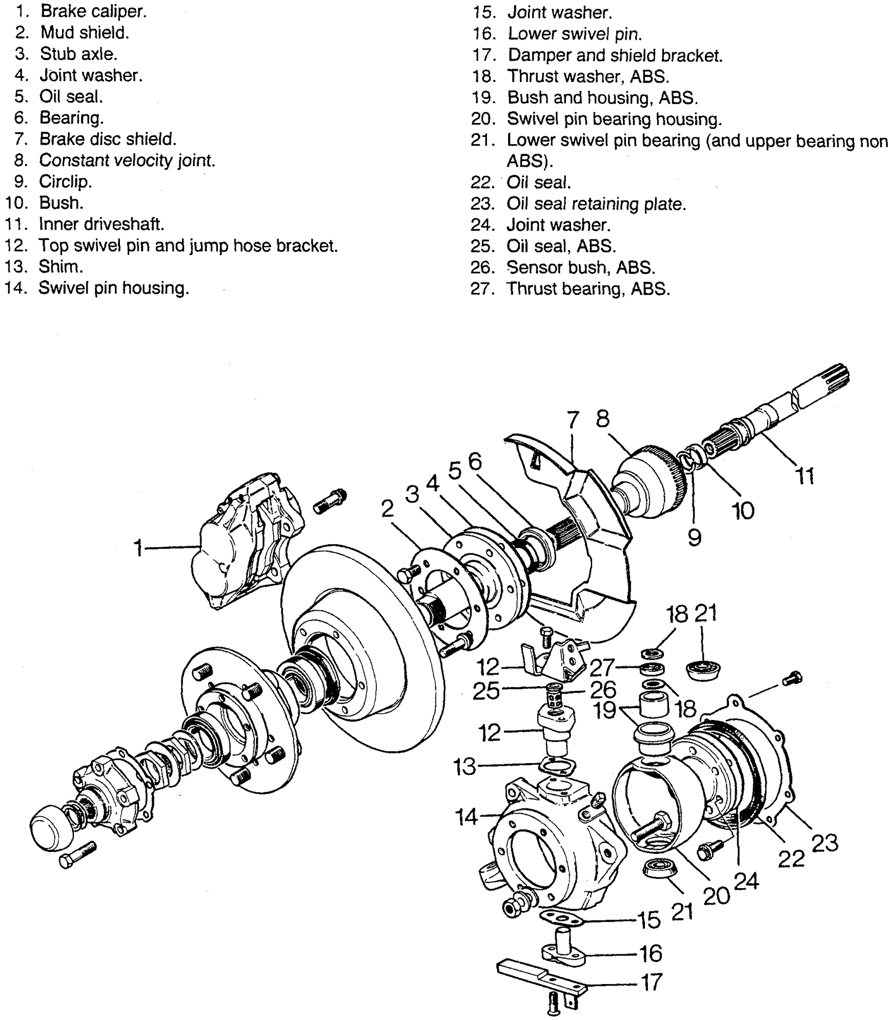

Pitting is a legitimate concern and cause for leakage/failure of the swivel, although it MIGHT not be that. The swivel ball is one big smooth surface and is sealed by a very large wiper seal. If the wiper on the seal is damaged, it'll leak. If the swivel is too pitted, fluid/oil will get out and onto the swivel/potentially run out while sitting if its dramatic enough.
Its a pain in the butt job, but definitely hobby mechanic level as long as you have a good head on your shoulders and a good mechanical sense of things.
If your "leak" is oil and not grease, you should make sure the inner axle seal at the base of the swivel is good, as that will allow diff oil into the swivel ball and thin out the swivel grease. Some folks run the swivels with oil instead of the grease, its up to you.
There is also a couple paper mating gaskets that could allow diff oil to leak out of if they bolts weren't tight or they did not clean the surfaces well, or did not install it right if they aren't familiar with the system.
number 22 is the big seal that is usually the leaker when the swivels go out. Very common to goof it up.
Number 5 is the seal that keeps the diff fluid out of the swivel. If it was coming in and there was something not quite fluid tight, it would leak diff fluid out of that point.
24 is the base seal between the swivel and axle housing, another leak point if installed wrong or missing as well as #4
