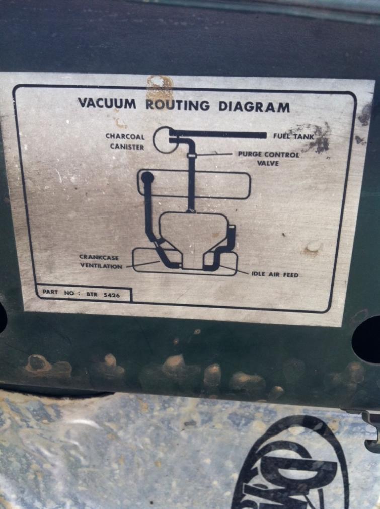

On my 94 D1 the lines are disconnected, Found a post here in regards to a D2.
Is it ok for these lines to be disconnected or should i hook them back up?
Thanks Guys

Unless they're plugged or connected, that's called a vacuum leak.
I think you're about to discover how much better your truck will run...

Usually the line on the passenger side attaches to the valve cover thru an oil separator. That sucks the oil fumes up to be burned off. A similar line is on the driver side, it goes to the throttle body and provides a source of filtered air to pass thru the engine and out the passenger side valve cover. If hoses are cracked, or what they plug into is sludged up, you'll have vacuum leaks, can build up internal open space pressure inside the engine to make oil leak out of seals, and can help sludge up the engine. Here's a pix of one of the areas they vent. Note that cruise control vac lines don't attach to motor, they have their own electric pump.
