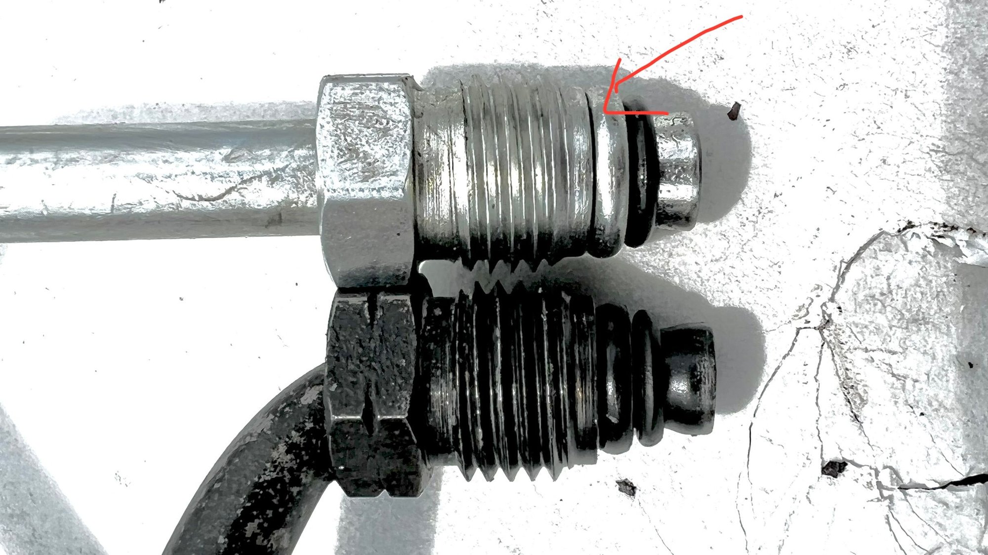

Are you using an AllMakes4x4 product? I had the same problem and when I compared it to another supplier, it was clear the terminating end was too wide to fit properly. See my photo below. The red arrow is pointing to the end of the hose where its too large to grab the threads of the steering box.
You're going to need a new hose or you risk stripping the port.
