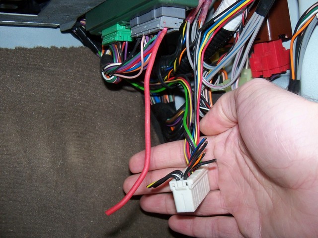

I just found this harness along the side panel near the alarm unti we talked about.
Any advice?

Front speaker amp.

THANK YOU!
That was confusing me.
Now it makes sense, they bypassed the front amp.
Now I just have to track down the subwoofer signal cables.
I hope they are in the same area.

Sure enough, the sub signal cables were in that harness running through the front amp.
I wired those through with the other patch cables and into RCA cables at the head unit.
Unfortunately the rear speaker cones were torn around the entire circumference of both speakers.
Now I must wait for the rubber to cure for a day before I can test everything.
