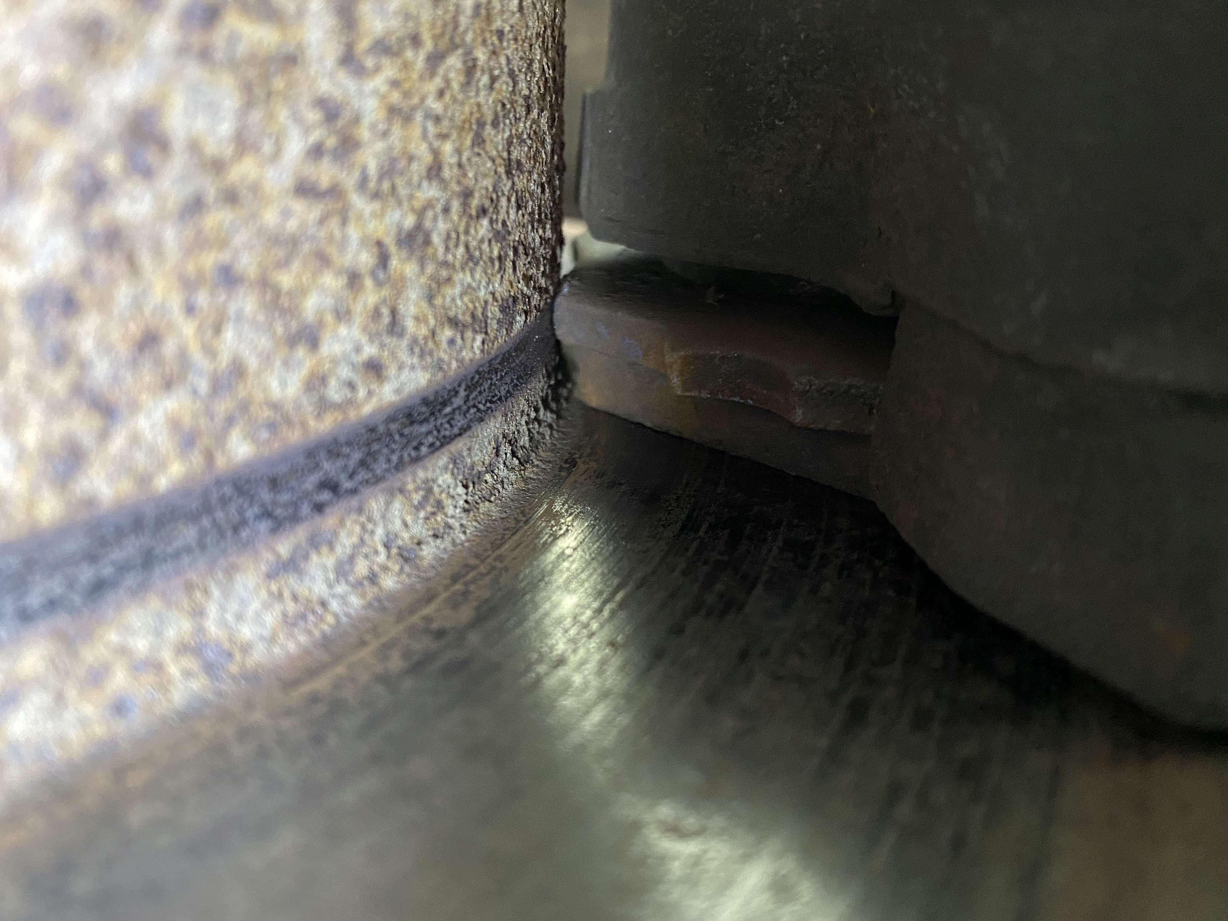

you want to know what the problem is? I'll tell you what the problem is. One of the pads has slipped from being squarely in the caliper and has tilted so that the metal of the pad will come into contact with the hub, causing anywhere from a squeak to a squeal. If you take off your wheel to adjust it and then drive it to the airport to pick up your kid, it can even start to jam in there and grind. Driving with your left foot pressing the pedal slightly gets you out of Oakland.
First round I took off my wheel and thought, wow, this will be an easy fix. So I took out the pads, cleaned everything and put them back in squarely. But one of them kind of shifted again so I re-adjusted it. Over and over. It just wouldn't sit square. Thought I had it but then the airport run. I fixed it by replacing the still-good pads with Brembo P44001 (rears) and got a positive lock in the caliper. Maybe I was doing something wrong, and maybe the last guy did too, but this solved it. Some of the pads have a step at the bottom but the Brembos are squared and just fit right.
If I'm right, you'll see a witness mark on the hub like below.
Attached Thumbnails Rear wheel chirp / squeak when driving, but gone when brakes applied-img-3873.jpg
