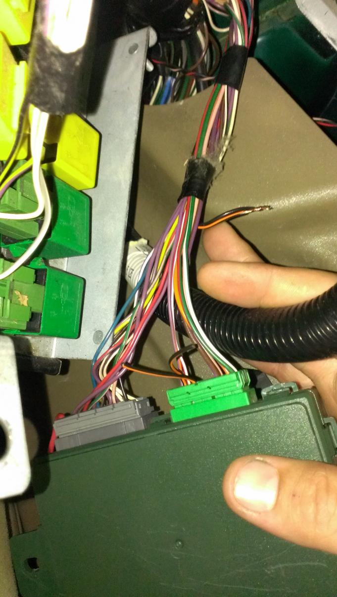

I found this pic for reference.

I found this tip on the net, anyone try this
Find the BLUE / GREEN (-) wire located at the Factory Security Module:
the FACTORY SECURITY Module is located under the PASSENGER hush panel far to the right. Requires (2) 7mm bolts removed to access.Connect one end of a piece of wire to the BLUE / GREEN (-) wire
Connect the other end of the piece of wire to Ground - (chassis)
This will Dis-Arm the Factory Alarm, until the wire is removed
Im assuming attach to the alarm module side.....?????
