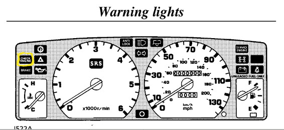

Originally Posted by Coachgeo
Answering my own question. In another recent thread (First post here )the CEL Was mentioned along with the Service engine light. Thus they are two different things and I do NOT have a CEL light showing.
For future readers. CEL location (in yellow) Thanks for the help thus far Suprised how many members with similar issues in the past and posted about them seem to no longer participate here at all. hmmm.

Originally Posted by No1pony
That was my post in the other thread. The reason my check engine light was not lighting up was the fuse under the dash was blown. Once I replaced that fuse my scanner would talk to the computer and I got the yellow light. I do not remember the fuse number but I think it was on top row 3rd fuse from the left. Hope that helps in some way.
Thanks,
For shiats and grins I'll check that fuse to see if the CEL not being on is a fuse issue and not a component of alarm issues.
