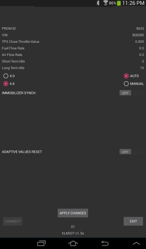

Released the android app. It'll work with any bluetooth elm327 compatible reader
https://play.google.com/store/apps/d...ms.gemsutility
works best with this one
http://www.scantool.net/obdlink-lxbt/
it'll get the job done, just slightly slower with this one
