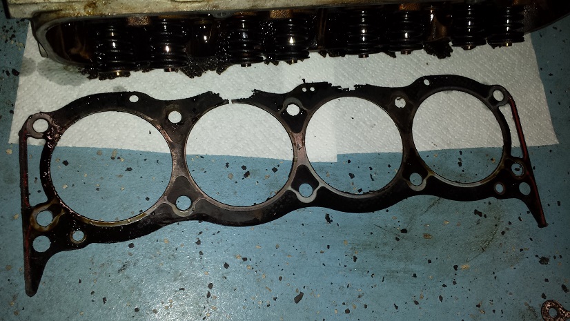

For about the last year or year and a half it was making a squeaking noise that I couldn't identify. I held a stethoscope up to each of the moving parts that the belt was on and nothing emitted the squeak. I ended up replacing the belt tension pulley bearing a couple times thinking that was probably it - to no avail. I just kept on driving it. And in the mean time, the exhaust started leaking and it was gradually getting worse. So about 3 weeks ago I took it in and had them weld up a crack in the y-pipe right up by where it connects to the exhaust manifold. The guy gave it back to me and said, "you still have something going on..." because it was puffing out by the exhaust manifold. He thought it was coming from one of the spark plug holes. It still ran great but it was very embarrassingly noisy to drive still.
I pulled the spark plugs on the driver's side out and everything looked fine. I figured it was probably the head gasket based on some youtube videos I'd seen. And that squeak had now turned into a "pfstt pfstt pfstt" sound.
So I ordered the gasket set and head bolts. Performed the 15 hour procedure and figured I was good to go now...

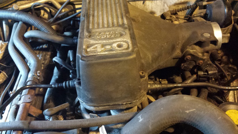

I tried pulling off the plenum cover and re-RTVing it.
That seemed to help a little but still definitely had a problem. I pulled the throttle position sensor off and tested the ohms on it with a multimeter as I moved it thru its range. That seemed to test out fine - the resistance changed steadily with the movement of the sensor. Then I took readings of the engine coolant temperature sensor when the car was cold and after it was warmed up. That seemed to be in range (340 ohms when warm and 2140 ohms when cold).

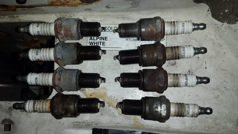

I got home and pulled all my plugs out, keeping them in order of which cylinder they came out of and they all looked pretty uniform and good colored.

I decided I would put the plugs back in the engine but in different cylinders that they came out of. Then I started routing the plug wires back to each of the plugs and clipping them in. It seemed that some of them were barely reaching the plug while others had lots of slack in them, so I swapped some wires out to different coils so that they all fit much better. I routed them so that they were not close to the firewall and were not close to the engine and were not close to each other - making sure they were going to the right cylinders (the coilpack has the cylinder number stamped into it that each wire goes to). I clipped them all in and was very happy with how orderly they now looked.
Figuring nothing that I had done would have affected anything at all, I took the disco for a spin and was extremely surprised to find out that it was no longer stumbling.
The car now runs very nicely - like it had before I did the head gasket job. I am thinking the fix for this was probably re-routing the spark plug wires so that they were neatly and efficiently routed to each plug. My guess is that they were either arcing to another wire or to ground somehow when accelerating under load. Either that or I had some of the wires going to the wrong cylinders, but if that were the case I wouldn't think that it would run decently for some of the time but not others...
