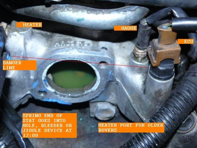

Nope, your thermostat is likely stuck open, or partial open. Replace with either 180 or 195, depending on if you are in the frozen waste lands of the north, where your Depends can freeze solid. Don't use one of the "fail safe" thermostats, it will latch open and do what you describe. The stat should be about $10, plus a gasket, plus 1/2 gallon of coolant. Spring end goes in this hole. Little jiggle device or tiny bleed hole goes at 12:00 position. Keeps a steam pocket from forming.
If the thermostat is closed, there should be minimal circulation near the ECT heat sensor and plenty of warm water.
If applying a radiator muff, don't use cardboard or somethng that will get wet and soggy and clog radiator fins.
Seldom are Rover radiators accused of being "too large".
Attached Thumbnails Running very cool - normal in cold weather?-danger-line.jpg
