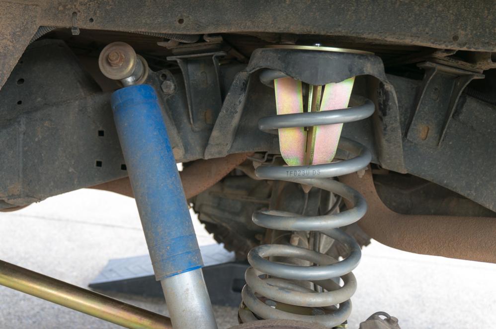

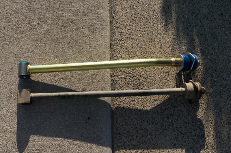

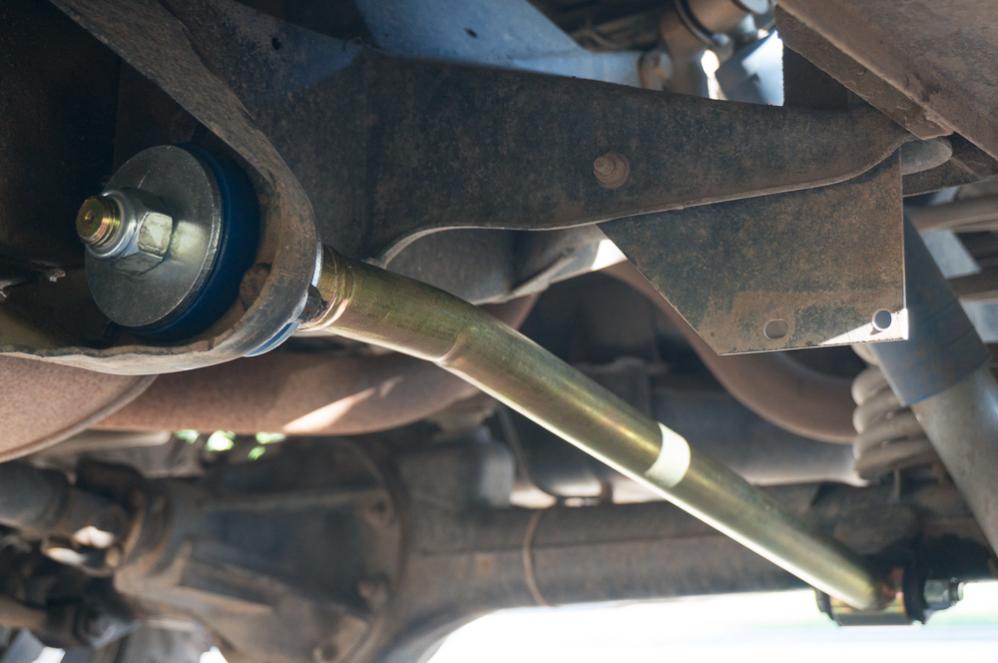

Trailing arms, polybushes, and cones installed.
Attachment 17943
Attachment 17944
Attachment 17945
Which arms/bushings are those?

I don't mean to be a douche but your shocks I "believe " are mounted incorrectly.
The washers should be turned the other way around to allow the bushing to turn.
Old Aug 30, 2013 | 07:06 AM
  #1939
CUpgt's Avatar
Joined: Apr 2010
Posts: 1,450
From: Upstate South Carolina
In all reality there prob isn't much need for the stock washers. I run RTE mounts and have used washers on the last 2 pair of shocks I've run.
Old Aug 30, 2013 | 07:57 AM
  #1940
drowssap's Avatar
Posts: 9,298
Likes: 318
From: Boston Strong
I'm talking about the cup shape of the washers, the cup should be facing out; not in.
