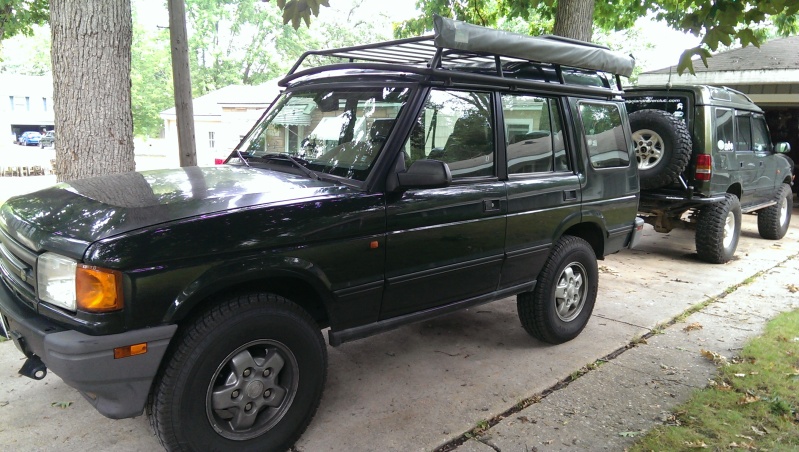

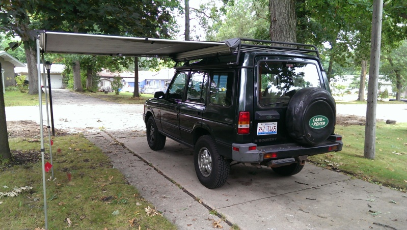

Picked up my new(to me) RockStar fab roof sliders/rack and Camping Lab awning.
The awning is just plain awesone and is going to be great for camping in the rain.
If you're unfamiliar with roof sliders, let me explain. Brad at RockStar uses DOM tubing, 1.5", and secures it to the rain gutters with a full length foot. The foot is basically 1/4" flat stock with the bottom cut to follow the slight curve of the roof line. What that all means is when you are off camber and get onto a tree you'll actually slide and not damage the rack or your truck. Pretty sweet.

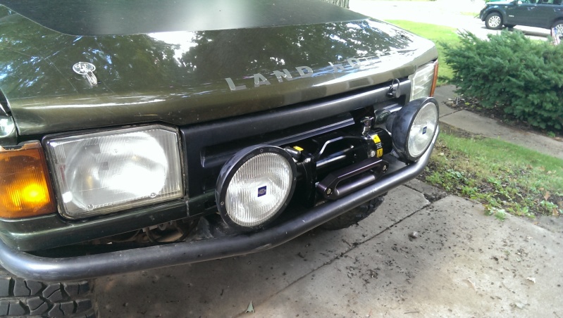

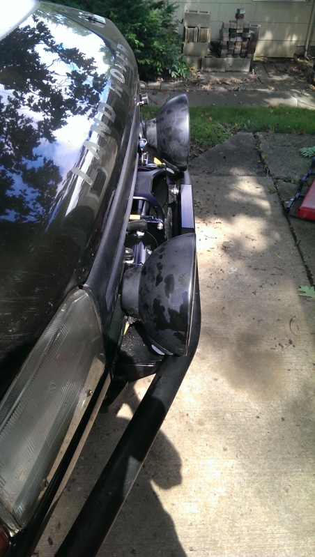

Got a lot done today.
First I mounted the Viking GS-9 winch and remotely located the solenoid.

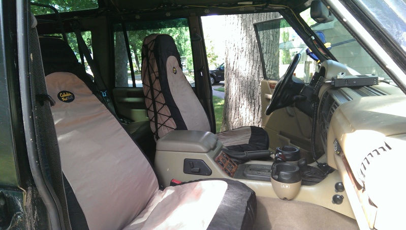

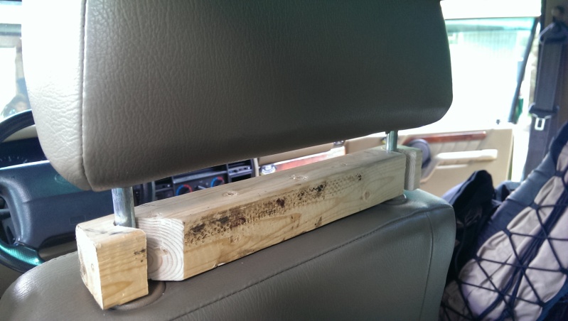

I got some Cabelas seat covers today. I got tired of the headrest always getting pushed down with the old seat covers so I made a spacer out of a length of 2x2.
And installed the covers. Pretty nice.

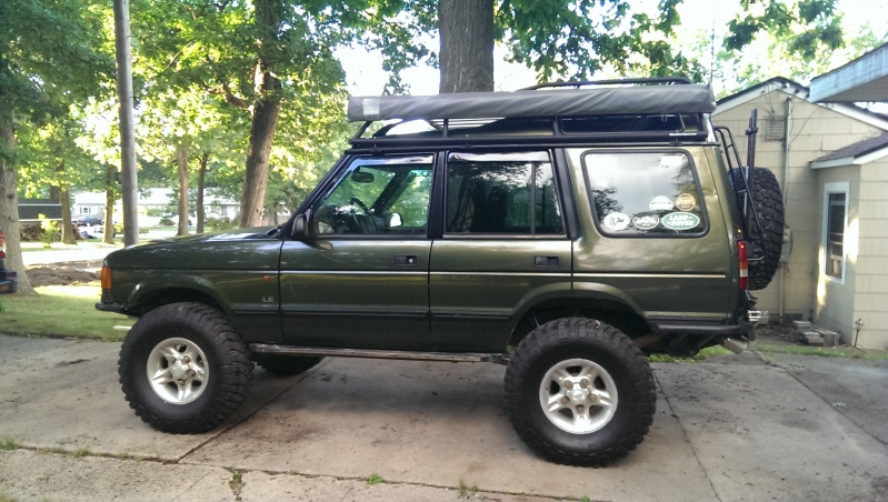

I also installed my freshly repainted ladder and swapped the RockStar Fab rack and Camping Lab awning over to the trail rig.

Looks nice FishEH! Will be nice to see in person lol ... The Awning is a nice feature, will come in handy im sure
