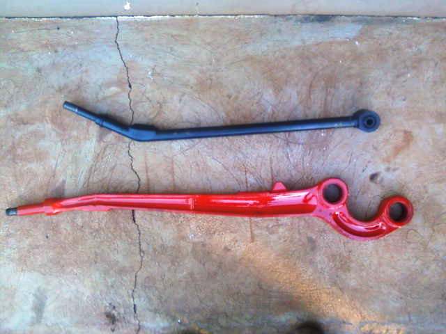

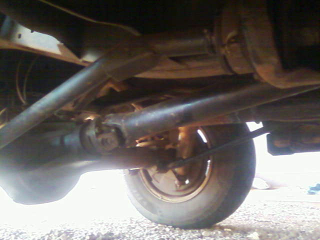

Got rid of of the roar by cranking the front Radius arm and achieved more correction on the front pinion angle. Did crank the rear as well and happy to see the result. Pinion facing transfer case perfectly.

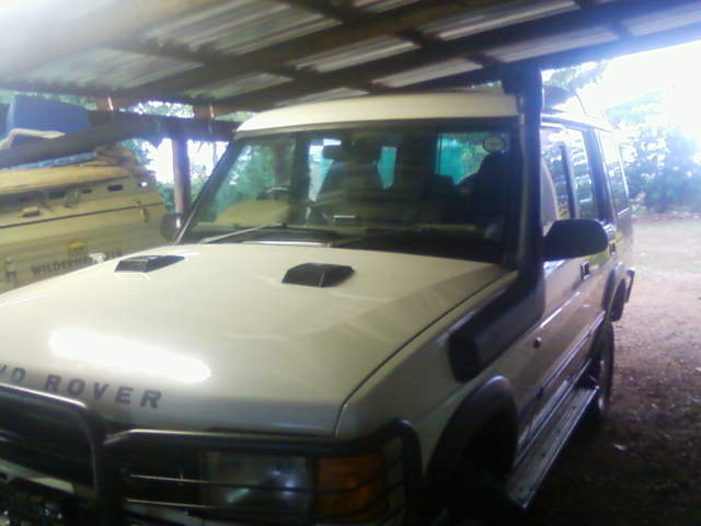

Opened some vents (Hood scoops) on the hood for more cooling on the V-TDi turbo.

Whose 2" springs you using that it needed the arms cranked? Just curious
Fitted Terrafirma Heavy duty springs with Big bore +2 Shocks

So that gave like 3.5 " lift?
Achieved little bit less than 3.5 ".
More to 2.5/3''.
