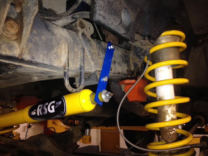

I believe the rear steering rod only had an angled replacement piece and two small u-bolts, to put the new steering damper in the stock location. I guess my question still isn't clear. Forget about the passenger side of the steering damper. What I need to know is if they got the bracket piece oriented correctly for the driver's side mount of the steering damper.
Let me try this. If I'm looking at the bottom of the steering damper, should it not go damper bottom into angled bracket, then the "leg" of the bracket gets secured to the steering rod? The way it's on now is reversed, in that the "leg" of the bracket runs underneath the bottom of the damper, then the damper bolts to the angled piece, there's nothing behind it. Doing it this way, those u-bolts that go thru the "leg" piece are too long, and they touch and interfere with the very bottom of the damper body.
I may flip this bracket around tomorrow, just to see what happens. If anything, it will only compress the bottom of the damper by a couple of inches, but at least it will move those u-bolts to the other side of where the damper bolts to the angled piece.

IMO the L bracket is backwards, I find it hard to believe they would not include a relocation kit, stock mount area is not ideal to off road, damper gets beat up

Go to your local hardware store and get a piece of 1/4" thick flat stock. Drill three holes in it and mount it as such.
That's obviously on a right hand drive vehicle but you get the idea. Move the ubolt bracket to the drag link in front of the axle and mount your steering damper between it and the flat stock you bolted on the frame.
