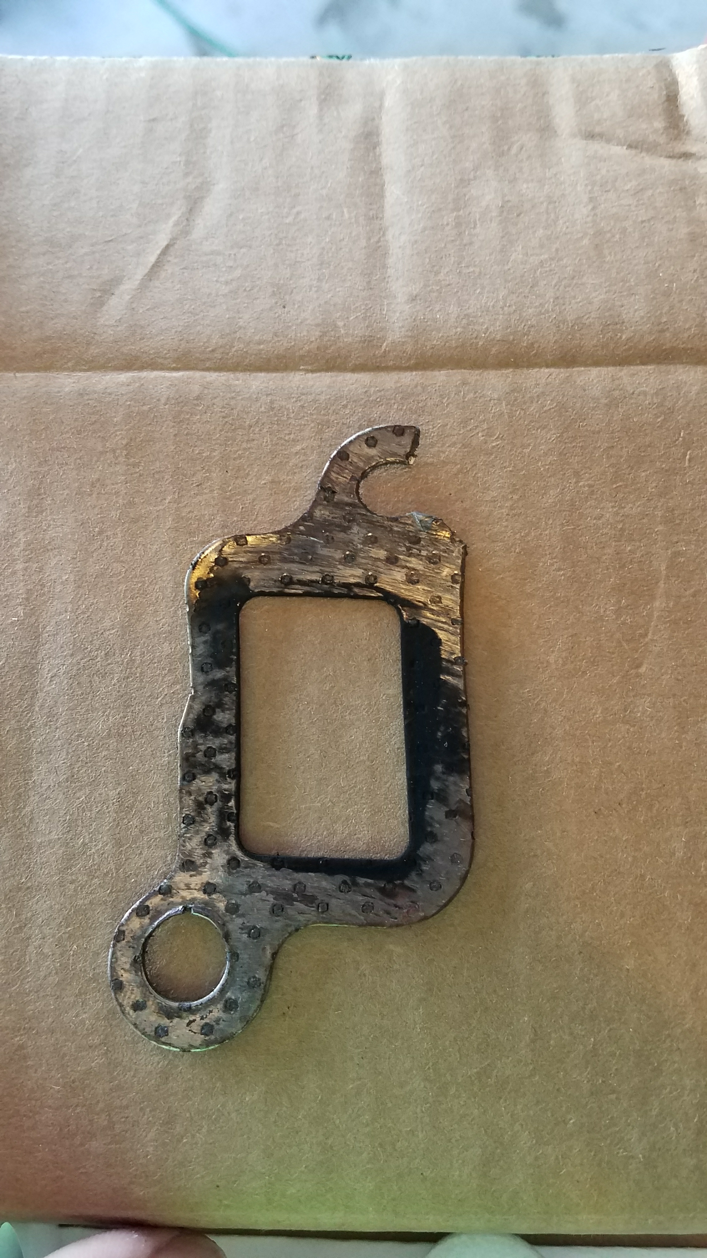

The exhaust gasket on my #8 cylinder keeps busting every 2 months and I can't figure out why... I keep it torqued to spec and was checking weekly. The bust is always in the same spot (top bolt hole). I tried the flimsy metal gasket and it happened as well. Any creative ideas to keep this thing from breaking?
Im to the point that I can change a gasket out in under 10 minutes...
Attached Thumbnails Stubborn exhaust gasket keeps busting-20170918_173050.jpg

Try doubling up the gasket on that port and see if that helps.

Just realized i forgot to add picture. It's now added.
I'll give it a try when I order more. I'm down to my last gasket

Check your motor mounts. I had the gasket between the headers and y-pipe blow out. I replaced the mounts and still going strong.

I like the motor mount suggestion. Have you checked the flange face for square?

Motor mounts are new as of last year. I haven't checked for square because I figured the bolts would square it up... silly me I guess
