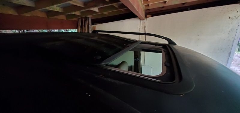

1997 Discovery. The front sunroof automatically opened upon starting the car. Its now stuck open, all the way retracted and tilted up. I opened the tab to the manual crank and stick a 4mm allen wrench in, but it won't budge.
I can hear the switch for the sunroof click...pause 2sec...click again. Then repeat after about 15sec. I've now pulled the fuse to the sunroof. But I need to crank it closed, and it can stay closed too. Is there something I am supposed to disconnect before manually cranking it?

Thank you for the note jimvw57. Yes, I sure did pull the fuse. I too thought maybe I was working against the motor. But no luck. I've also had a family member operate the open/close switch as I added pressure to the glass forward and backward. I inspected the track on both sides of the sunroof and as best as I can tell, I'm not seeing an obstruction.
Should the process be as simple as, insert an allen wrench into the manual control and twist (I tried clockwise and counter-clockwise)? Or a I missing a step?

Thanks for the note. Ya, when my 17-year-old son told me the sunroof was open, I read him the riot act for opening it. He's been around these rigs a lot and knows better than to open one of them. He swore up and down on his life that he didn't open it and that the vehicle opened it on its own upon starting the car. And I now see I have a rear dome light flickering which I can not get to extinguish. I'm now pulling the battery leads off to assure it doesn't kill the battery.
So between that behavior and what I've read on these threads about compromised wiring and how it can make those sunroofs move on their own, I let my son off the hook. I guess I will have to do some searching of what the mechanism looks like inside to understand what could possible be preventing me from hand-cranking it. And ya, I guess I will have to have my first shot at taking the head liner down.

When the Sunroof ECU either gets wet or corroded it's very common for the sunroofs to just magically open. If you disconnect all the connectors to the Sunroof ECU = it will no longer activate the sunroofs. For the dome light check all of your door switches to make sure one isn't stuck or not working properly.

Sunroof ECU is right up there behind the switches/dome light area. You should be able to pop the switch plate out the way and unplug it.
