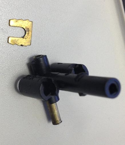

Tabs:
Dirty & Cleaned:

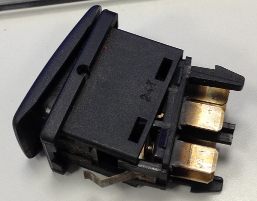

Window Switch:
4 tabs to pop

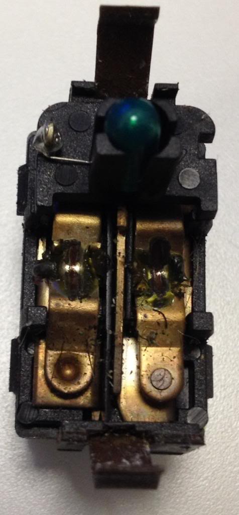

Internal layout
notice the tabs are opposites

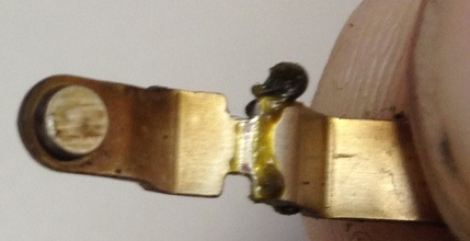

Bulb for the window switch illumination, this should be able to be replaced with an LED/Resistor combo if you chose to.

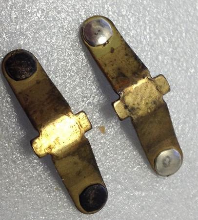

Pic of the undersides of the tabs:

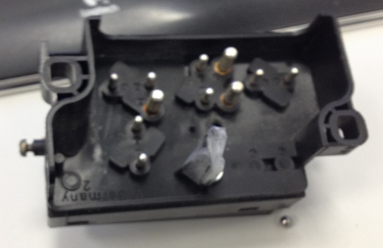

blurry underside:

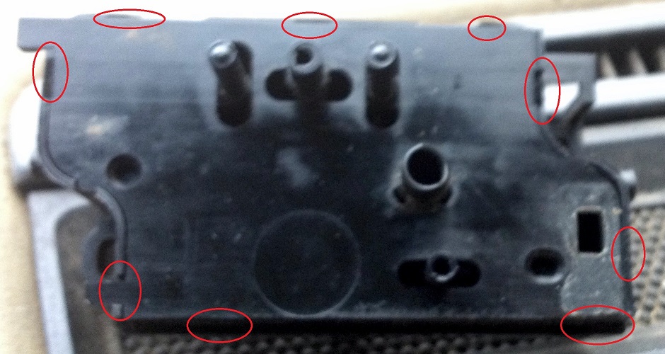

pop tab locations:

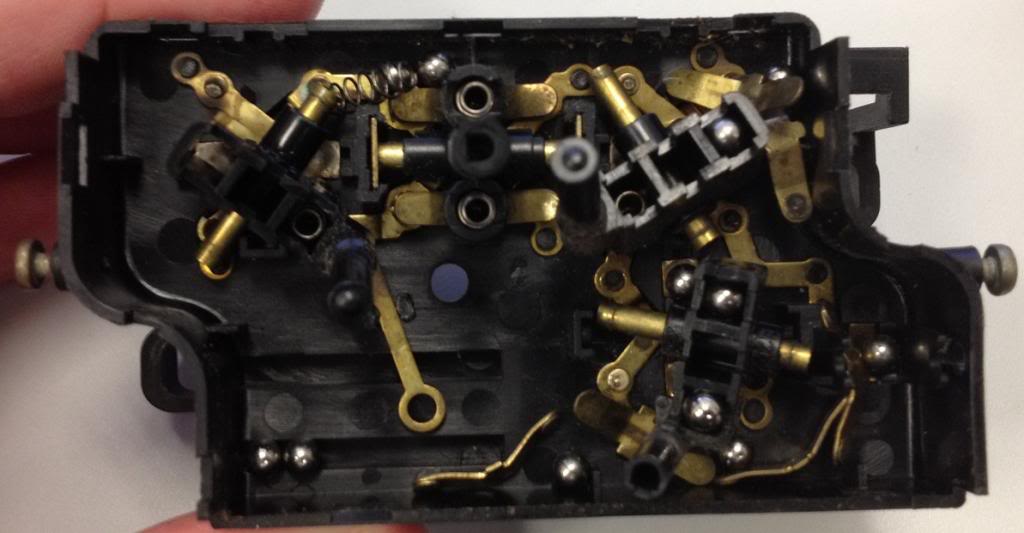

messy inside:

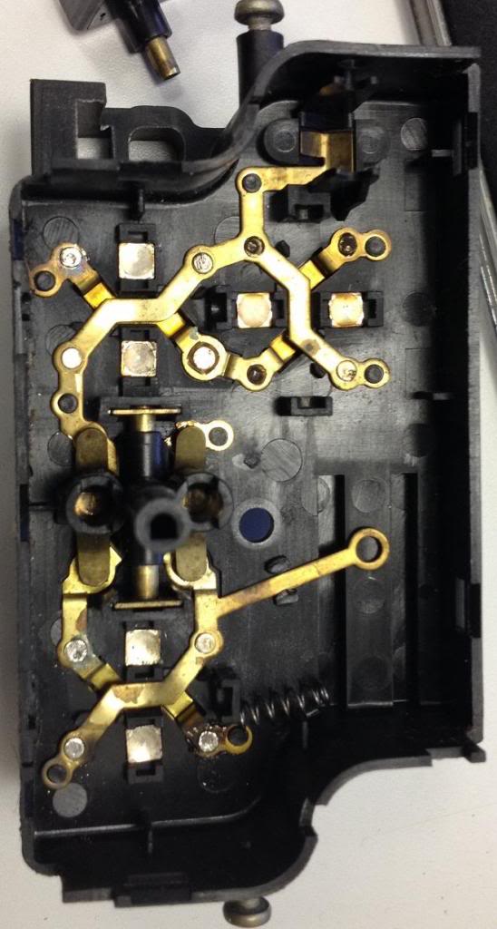

Inside: cleaned up

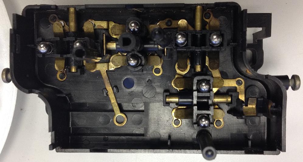

inside re-assembled (WRONG ORDER FOR THE SLIDERS!!!!) Be aware of this, the first time I re-assembled I had goofed the order of the plastic sliders. The proper order is:
2 like sliders go on either side of the main slider (mounted) are identical, make sure the side that has the extra plastic goes towards the outside (otherwise it will interfere with the operation of the switch.)
Also the slider with the offset end goes at the bottom of the switch, again you can use the cover to make sure the alignment is right.
A few notes for the re-assembly...
there are 2 ball bearings and a spring for each tube in the sliders (4 bearings and 2 springs per slider).
These are kind of a pain to deal with but fortunately the springs are flat topped and hold the bearings in place for re-assembly.
Get everyting in place like the last picture (just make sure the sliders are right lol) and then go SLOW when re-assembling the unit....
My instinct was to try and snap it in place quickly, but this proved to move the top bearings away from where they belonged, when I slowed down and tried to sneak each tab down a bit till I could snap it in place it proved to be quite easy.
After re-assembling, shake it ... If the bearings came loose the switch will rattle.

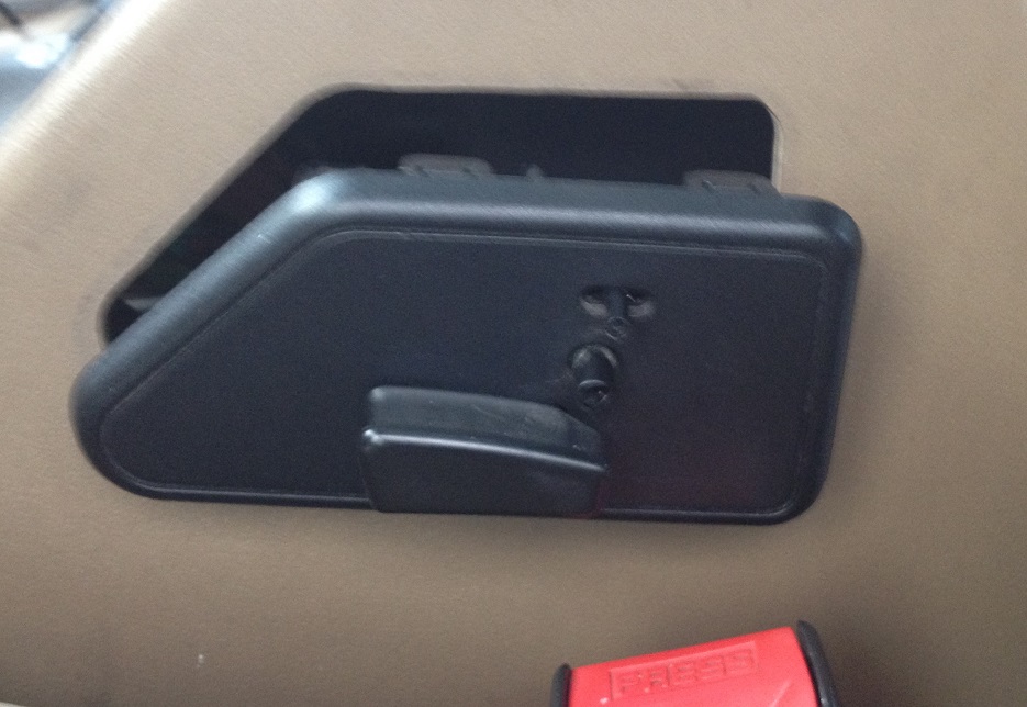

How do you get that fixed?? Got the seats working but can't figure out how to get them back in?
Old Feb 19, 2018 | 08:32 AM
logan_gibson's Avatar
Joined: Jan 2017
Posts: 259
Likes: 39
How to get the seat switches back in?
They have 4 tabs, two on top two on bottom. Usually the bottom ones are broken off so it doesn't snap in and stay put.
You can get a replacement cover with the 4 tabs off eBay usually.
Old Feb 19, 2018 | 08:44 AM
Paulodelson's Avatar
Joined: Jan 2018
Posts: 10
Thank you. I had a feeling something was broken/missing
