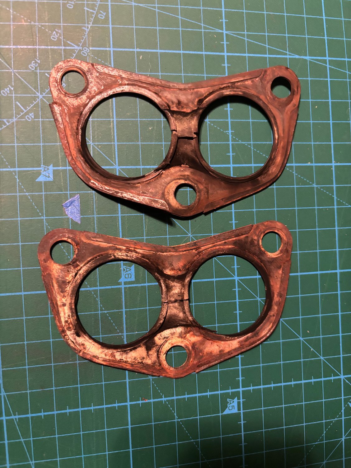

Thanks for the advice Johnzo. I removed the Y-pipe and found the source of the engine tap - a cracked exhaust manifold gasket. It seems once the engine heated up, in some conditions the perforation flapped in synch with the exhaust creating a tapping sound. I installed new gaskets and the engine sounds good again. I have a photo below where you can see the cracks in both gaskets, although only one flapped and made noise.

Glad you found the problem! All those Rover V-8 gaskets end up with cracks there because there is a gap with no support on the Y-pipe side. So not likely was a flapping sound. More likely the joint was not sealed (leaking). That might be indicated by the non-crushed sections of the inner ring folds in the photo.
When mine leaked, it was especially noticeable when giving a little gas going slow up a steep incline, like some driveways. I was certain it was metal parts knocking together, but no, just an exhaust leak.
