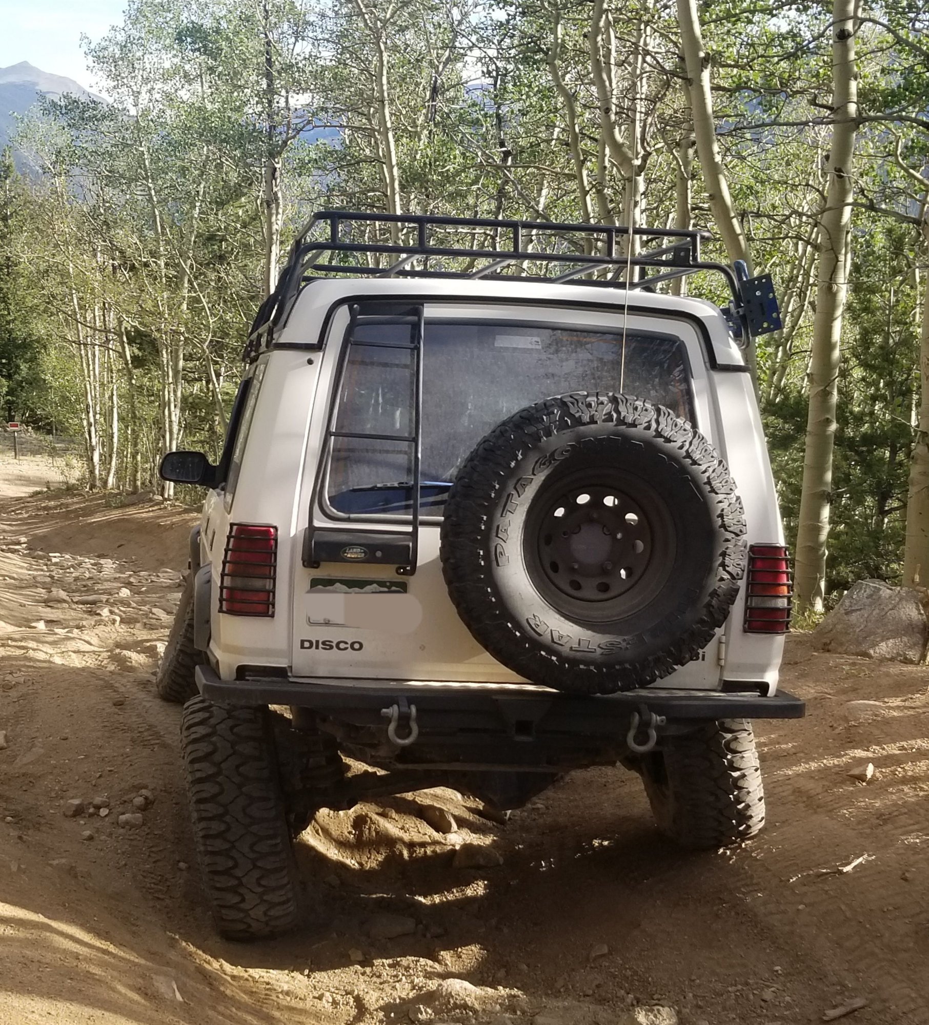

From: Parker, ColoRado
This is where my 315/75 sits. I did have to add the Rover Connection mount to my modded OEM mount to get it to fit. I will post a picture of mount setup when I get home.
