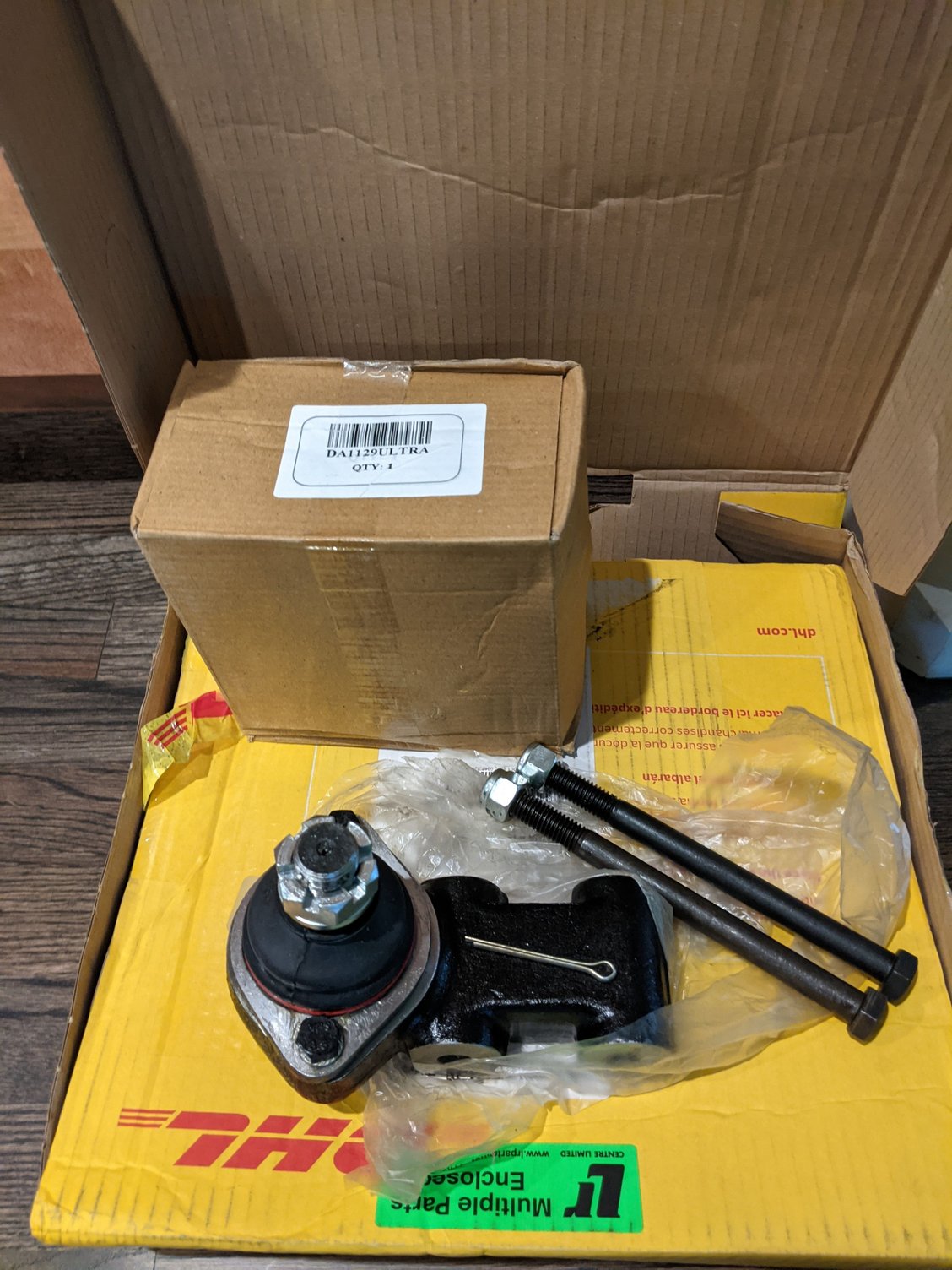

I've been hearing an odd popping noise under Indy that seems to keep getting worse. I inspected the A-frame ball joint and it's totally shot. I didn't want to worry about removing and replacing the ball joint in the existing fulcrum, so I ordered a kit from the UK with the ball joint already inserted into a new fulcrum. I also ordered the high articulation version since it was only a few bucks more.
I'll report back once it arrives and I've had a chance to install it.
DA1129ULTRA KIT W BOLTS
One of the major factors limiting the rear suspension movement on vehicles fitted with an A-frame is the standard ball joint. We have developed this part to provide significantly more articulation than the standard and most aftermarket joints. Others claim more articulation yet in reality they offer very little over the standard 30°.
This exclusive ball joint offers 45° movement in all directions. It is easily adjustable with a regular hex spanner and has a grease nipple for convenient regular maintenance.
It is supplied fitted in the mounting bracket ready to bolt to your Land Rover and this kit even includes the bolts to fit it!

The upper ball joint and fulcrum just arrived from Liverpool, UK. I ordered on Tuesday, they shipped it on Wednesday and it was delivered today. We have mountain weekend plans, so this will have to wait until next week or likely longer. I just checked my parts stash and I have the bushings for the front radius arms NTC6860, but not for the rear upper links NTC1773. I now have to place another order.
