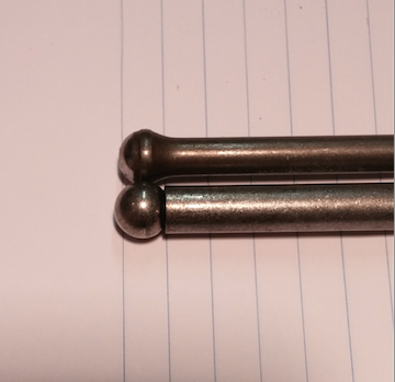

Got the new pushrods in today and in comparing the new to old, notice that the new pushrods are slight longer, see attached picture. Just taking a quick measurement, I'm guessing about a millimeter, maybe a touch less. Is this due to wear and tear of the old push rods and would imagine that after 150k, that may be normal.
I order pushrods with part #603378.
Is it safe to install the new pushrods? I'm replacing the entire 16 rods as I was somewhat thinking that wear and tear may have cause these rods to be shorter or warped over time.

New original pushrods would have a ball as well and the fact that they are short is because they are now mushroom shaped. So yes, the new pushrods are correct and will open the valves just that much more. The wear is normal specifically if the top end wasn't receiving enough oil. I'd say they're ready for replacement.

Thanks, I'll replace them. Was debating on replacing them all or not, guess it was a good call to replace all 16. And based on the clogged oil ports I found, I'm guessing that best case was that very little oil was getting up there so hope the cleaning will help.
