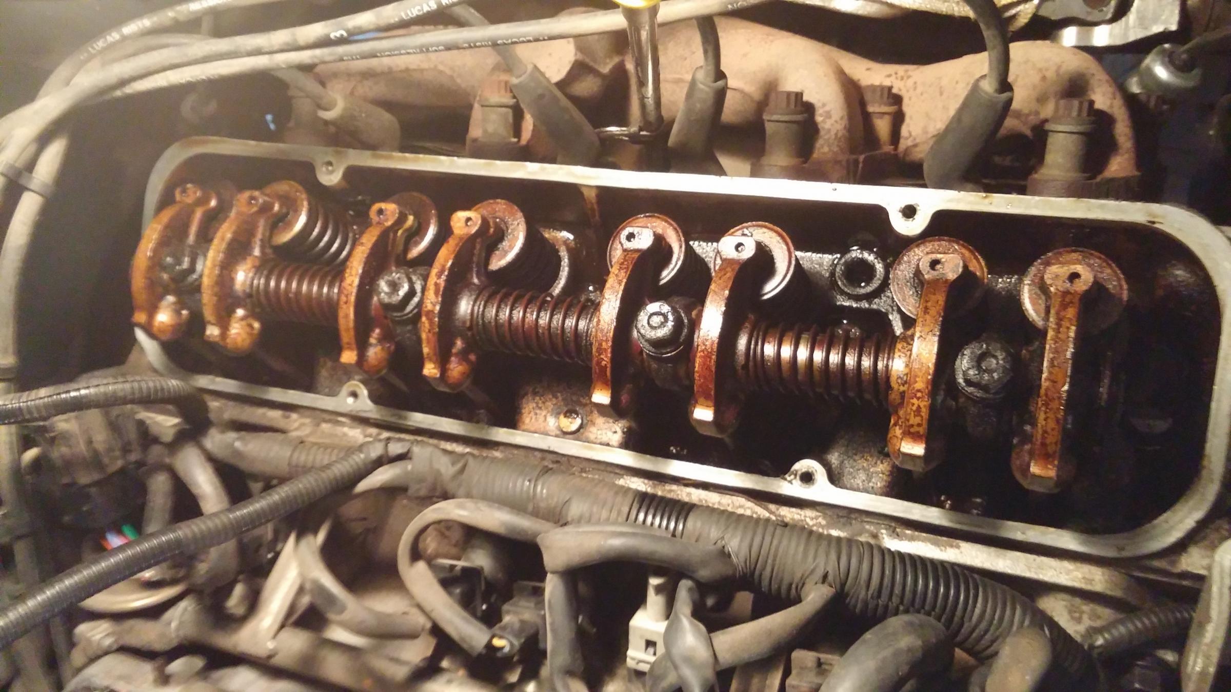

Sorry, duplicate picture

sounds similar to my issue read:
https://landroverforums.com/forum/di...-issues-60906/
I second(third?) the advice about the missing steel reinforcement from one of the lifters.
https://landroverforums.com/forum/di...s-60906/page5/
Page 5 has some pictures, the "nipple-rod" and the failed seat in the rocker. I had to replace 2 pushrods and 2 rockers both on the drivers side.
Your engine looks amazingly clean, perehaps someone has been in there before? (you can compare to my pictures too ... inside mine was black

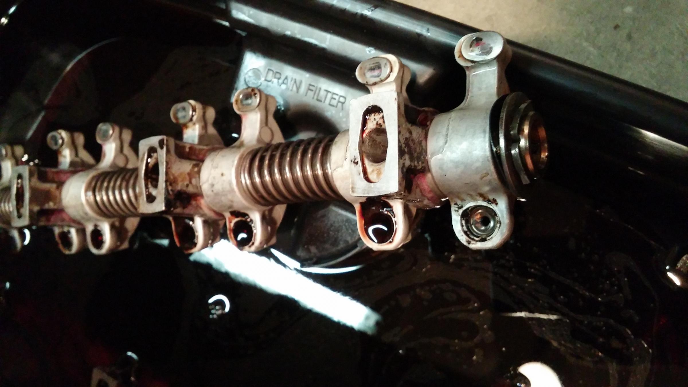

I went ahead and took everything out and removed both sides. The
Holy crap, them things are dirty.
Cleaning the plenum/intake, the idle air port was covered in sludge and the iacv was dirty so gave it a good cleaning. The port from plenum to passenger rocker was completely clogged.

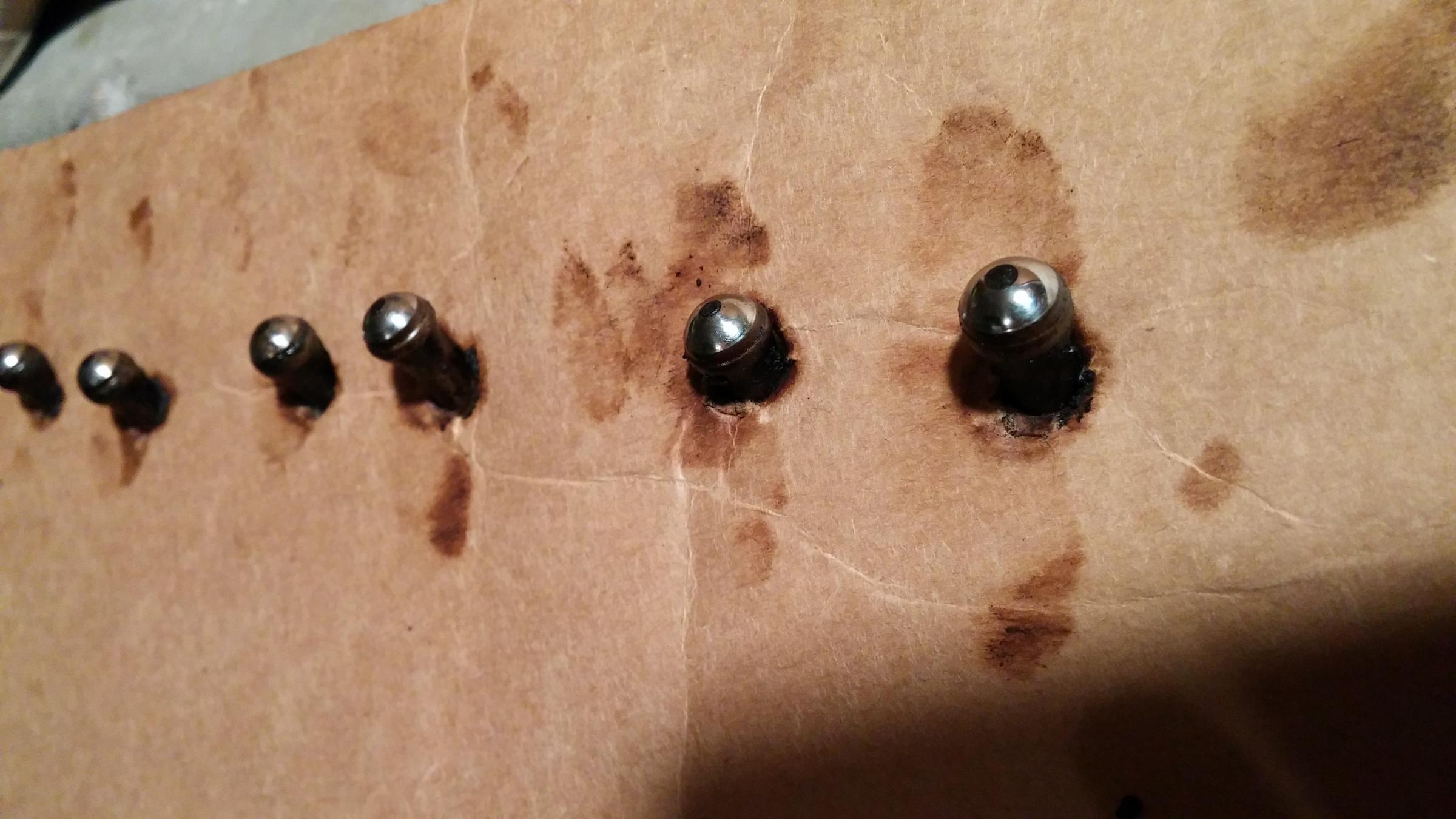

nuclearw - I'll read your post in a bit more detail tonight. I'm second owner since 30k and as far as I remember, I don't recall anyone being under the cover but was in in the shop multiple times while under warranty and few times after so who knows. I did notice the picture of the pushrod indicating a nipple but all the push rods on my vehicle does not have nipples, see attached picture. Second picture of rocker soaking for an hour.
Both valve trains are soaking right now so I'll post some pictures tomorrow after it it cleaned but I did get a couple pictures.
A couple questions I have:
1. The oil port in the rear of both valve trains were closed to being completely clogged if not 100%. I took a small screw driver and cleaned it as far in as I could, it was filled with sludge. I took blow gun to it and air can be hear passing through now. But it still feels like it's not completely clean compare to the front port, which easily blows air through.
2. Is there anything that I can use, i.e. chemicals to clean that port? I suspect not without ruining the oil and if not the engine.
I also have the gaskets on the way.
Attached Thumbnails Valve Noise Help-rockerbeingcleaned.jpg   Valve Noise Help-pushrods.jpg

good deal, sounds like yours may have just been oil starvation then, keep cleaning then inspect the rockers and see if any seem off, one of mine was destroyed as in the pic, the other was not anywhere near as bad but you could still see a ridge on the pushrod.

Cleaned up the rocker assembly and all the parts look to be in good shape. Springs are still very strong taking a bit of force to push in. However, when I checked the pushrods, none were visibly bent but I rolled each one on my cast iron table saw with a very flat surface and discovered 2 bent, one very obvious on rolling and the other barely both on the driver side and where I hear the noise from. The rest rolled along fine and no bent rods on the passenger side.
Question: Can I replace just those 2 or should I replace all 16? I looked online and it appears that the replacements are those rods with the ball at the end and not like the originals. The only place that I can see with rods that look like originals is British Atlantic.
Old Sep 28, 2014 | 03:59 PM
nuclearw's Avatar
Joined: Apr 2013
Posts: 351
Likes: 9
From: NE-Illinois
You can replace just the 2... if you have money for it go ahead and replace all of them. The new style you describe is what I used, so far they have mixed well with the rest. I did replace the rockers they went along with as well, so not sure if that made a difference.
