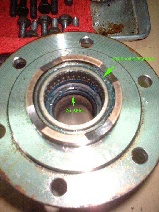

stub bearings in the housing? like i pull the axle and swivel ball and its in there with a seal right?
yeah, behind the seal. Roller bearing.

i see why i did not do them at least on the front, requires breaking down the swivel and removing axle and cv from swivel housing?

Yep. I do em w bearing replacement.
