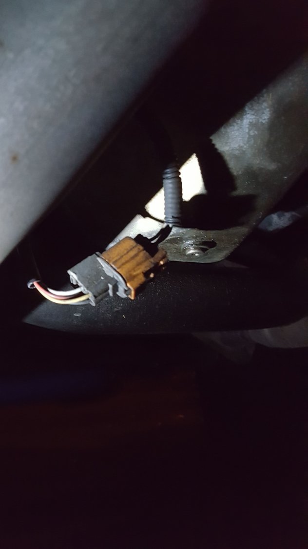

What is this dangling? The crank sensor connection??
the wire connector to the crankshaft position sensor plugs directly into the sensor, its on the lower part of the engine block, at the rear of the engine ( where the flywheel is) and usually has a tin heat shield ( bwhahahhaa ) covering it....the wires to it get heat baked and the insulation crumbles off allowing water to short it out .... google the sensor for a pic of it
this looks more like an O2 sensor connection ?
