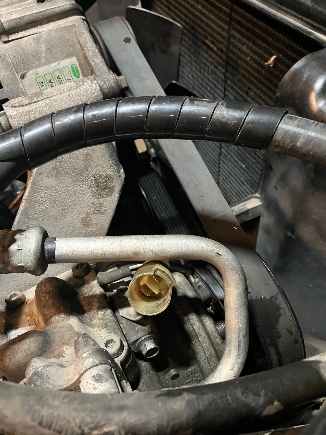

I can’t find what goes connected to this? What I’m missing?

Looks like a D1. That is the electrical connector to engage the compressor. C145 in RAVE. There should be the complimentary plug nearby
Some route the wires over the top of the A/C compressor. I believe stock is for it to emerge from the outboard side.
