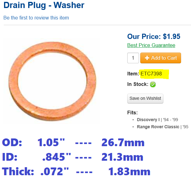

I put the first oil change on my 98 and found the PO hadn't used a gasket on the drain plug and I couldn't find where I had put the 10 pack I had tracked down for my 96. NAPA doesn't even list it by application, either. I put it back together with a 90 durometer o-ring I had (wife was out of town with the other car!), but it bothers me and I will change next weekend. I'm remembering 1" ID, but surely someone has it written down or a spare to look at!

ETC7398....Have at it

Perfect - as an old parts man who gives a darn, I do appreciate facts! That really should be a sticky! Russ
