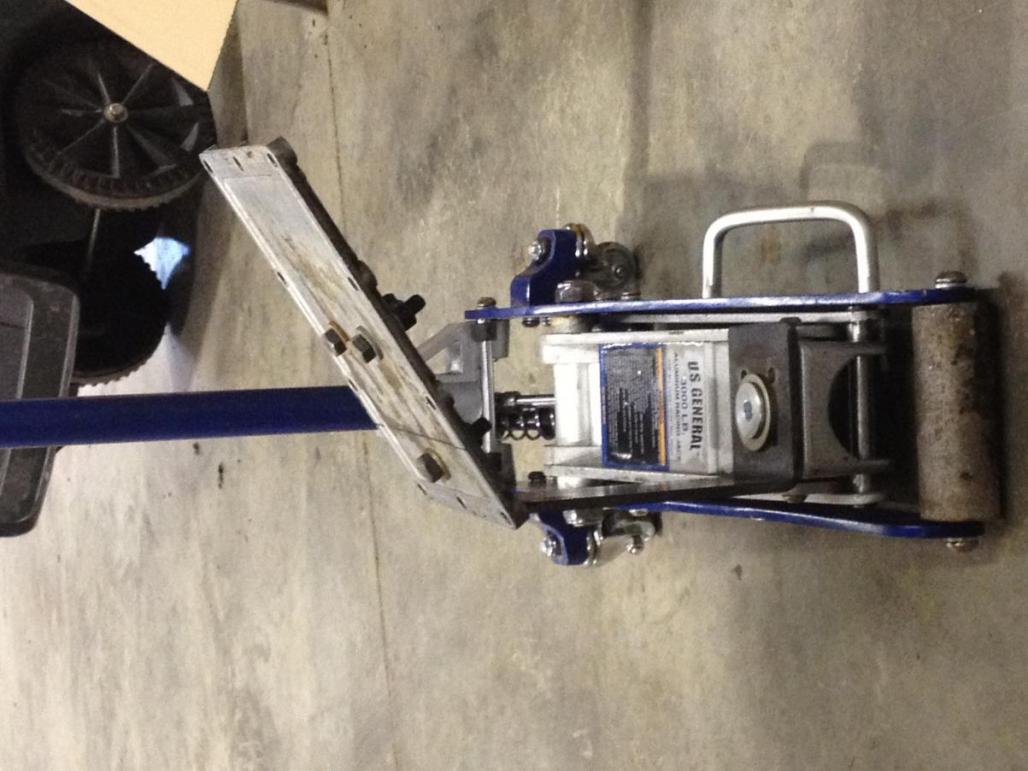

This may help, if you nab a cover plate from a donor truck....

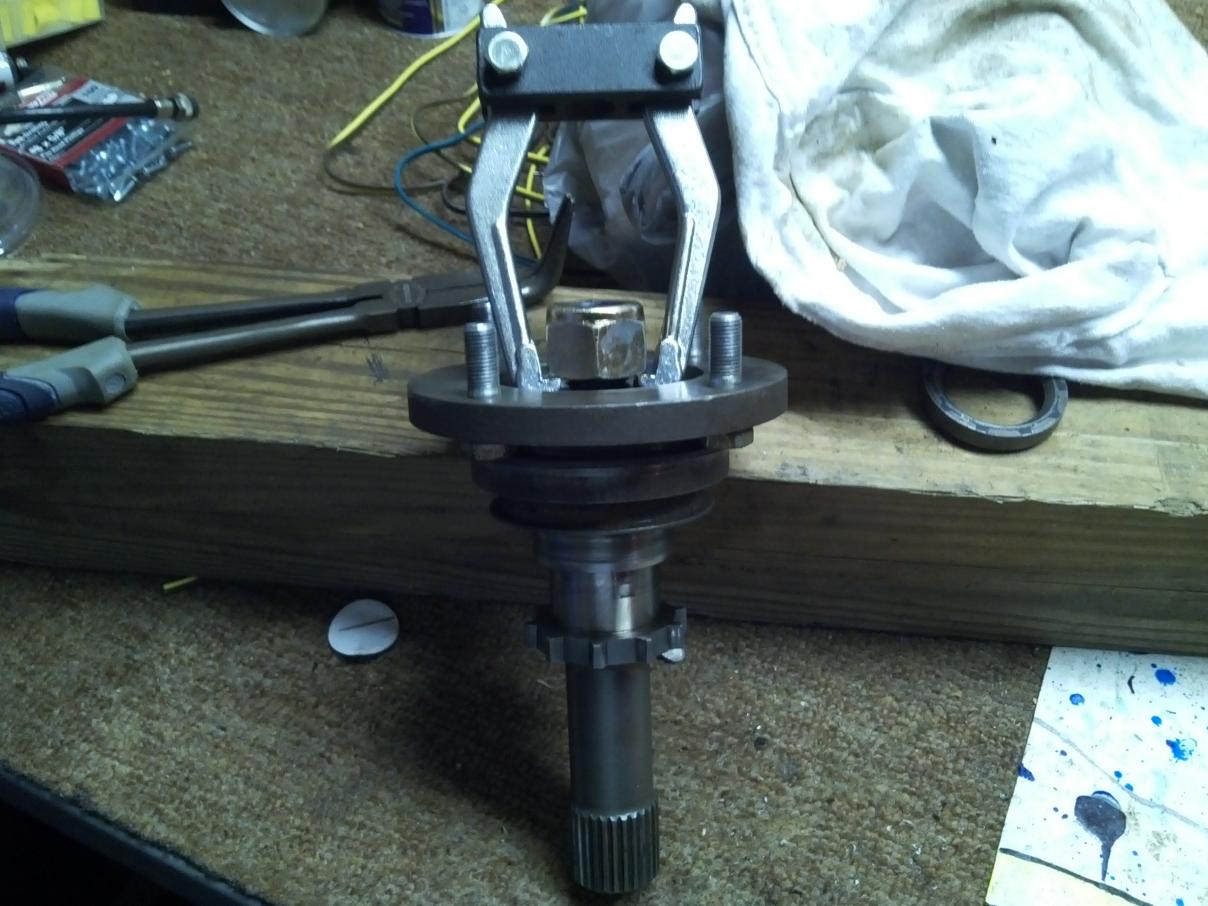

Finally got around to reassembly today and dammit. That wasnt it. So i pulled the front bearing and shaft an it definitely feels and looks like its the culprit. Got bearing and seal on order will post back with results. Oh yea, the slide hammer worked like a champ . Just for any body else trying this. This was my attachment setup
Ha, funny to see my picture floating around still. That was the easiest way to bolt onto the transfer case without having to precisely drill a bunch of holes. That angle the case was perfectly balanced on the jack and stood on its own, made installing it easy. Still got that tool somewhere in my garage just in case.
