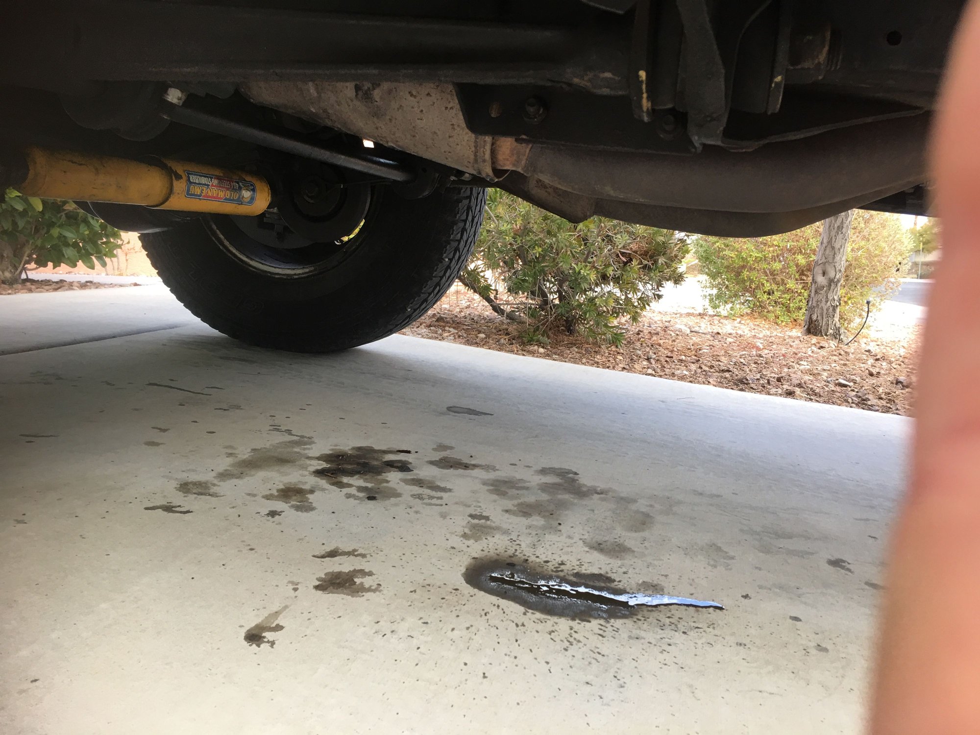

The engine compartment is starting to clean up. I have been running my D1 with an OBD2 reader since I bought it this summer and the engine has never gotten above 200* even with the AC on during the 110* summers. Yet I do have a slow coolant leak at the rear driver’s side valve cover gasket (#7 cylinder). It is dripping about once every 10 seconds.

Valve cover gasket leak

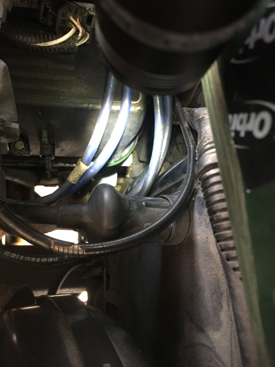

dripping on the cat
Missing exhaust manifold bolt
I kinda wonder if someone did a half assed HG job and just didn’t do a very good job?

I'd guess the bolt on the exhaust manifold broke and is still in the block and am surprised you don't have an exhaust leak. In fact, an exhaust leak is what you my be hearing as a 'tick'.
Regarding coolant at the base of the valve covers... does anyone else think that is an odd place to find coolant?
Old Jan 30, 2019 | 09:45 AM
OverRover's Avatar
Posts: 2,514
Likes: 656
Yes, strange place for a head gasket leak.
I would be looking at the Throttle Body Heater Plate Gasket and the hoses going to it.
And IMHO, those Home Depot hose clamps are garbage.
Also check the TBH Plate itself, it's very easy to get a small crack or even loosen the nipples when removing the old hoses.

For the exhaust manifold bolt, I haven't probed the hole yet but I agree that it probably has a piece of the old one lodged in there. The ticking though sounds like it is coming from the other side of the engine (under the passenger side valve cover) i.e. lifter, rod or rocker, perhaps. I have a video on my phone that really gives the listener clear sound of both the ticking and the whine in the front of the engine which started just before xmas.

You guys were right. I have a leak at the hose connecting to the TB heater. I think the heater hose may be to large inside diameter, so I’ll get some new hose tomorrow. I hope that takes care of the leak without pulling the TB off.
Now on the exhaust manifold...I probed the missing bolt hole and it appears that it may just be really dirty but clear of broken bolt bits. I need to clean and chase the threads. I checked the rest of the EM bolts and all but two were loose and one was finger tight. So it’s not out of the realm of possibility that the missing one just fell out and PO just never noticed. I think new gaskets and bolts may be appropriate.

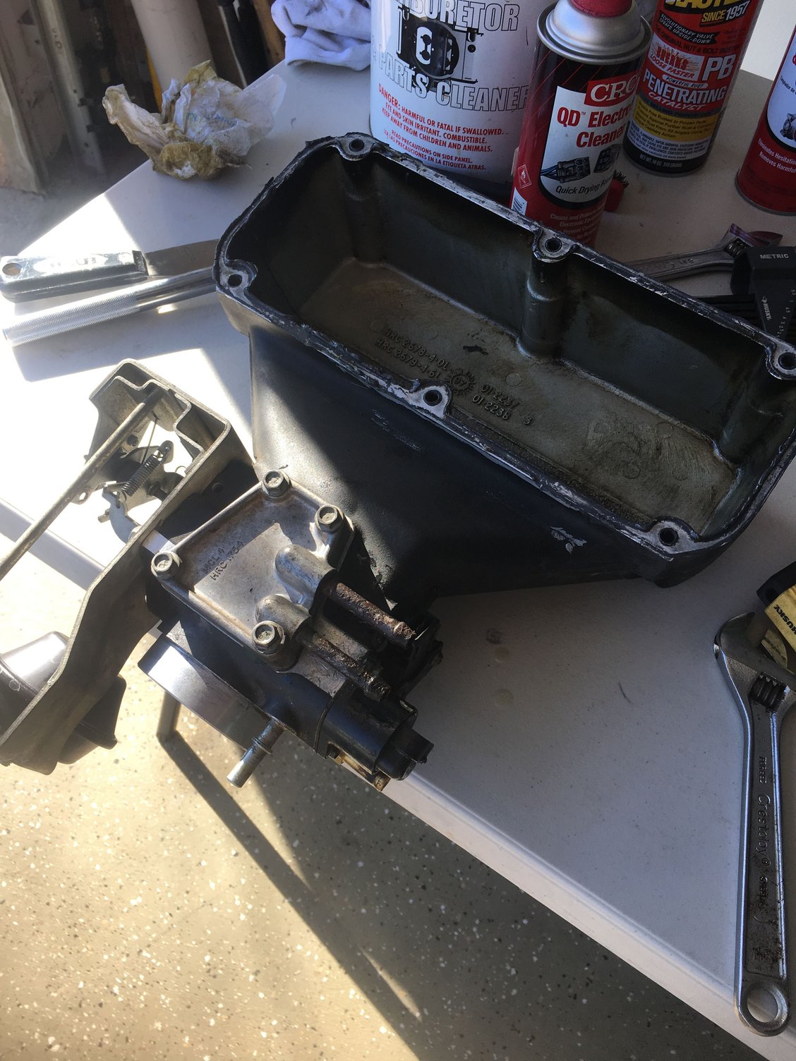

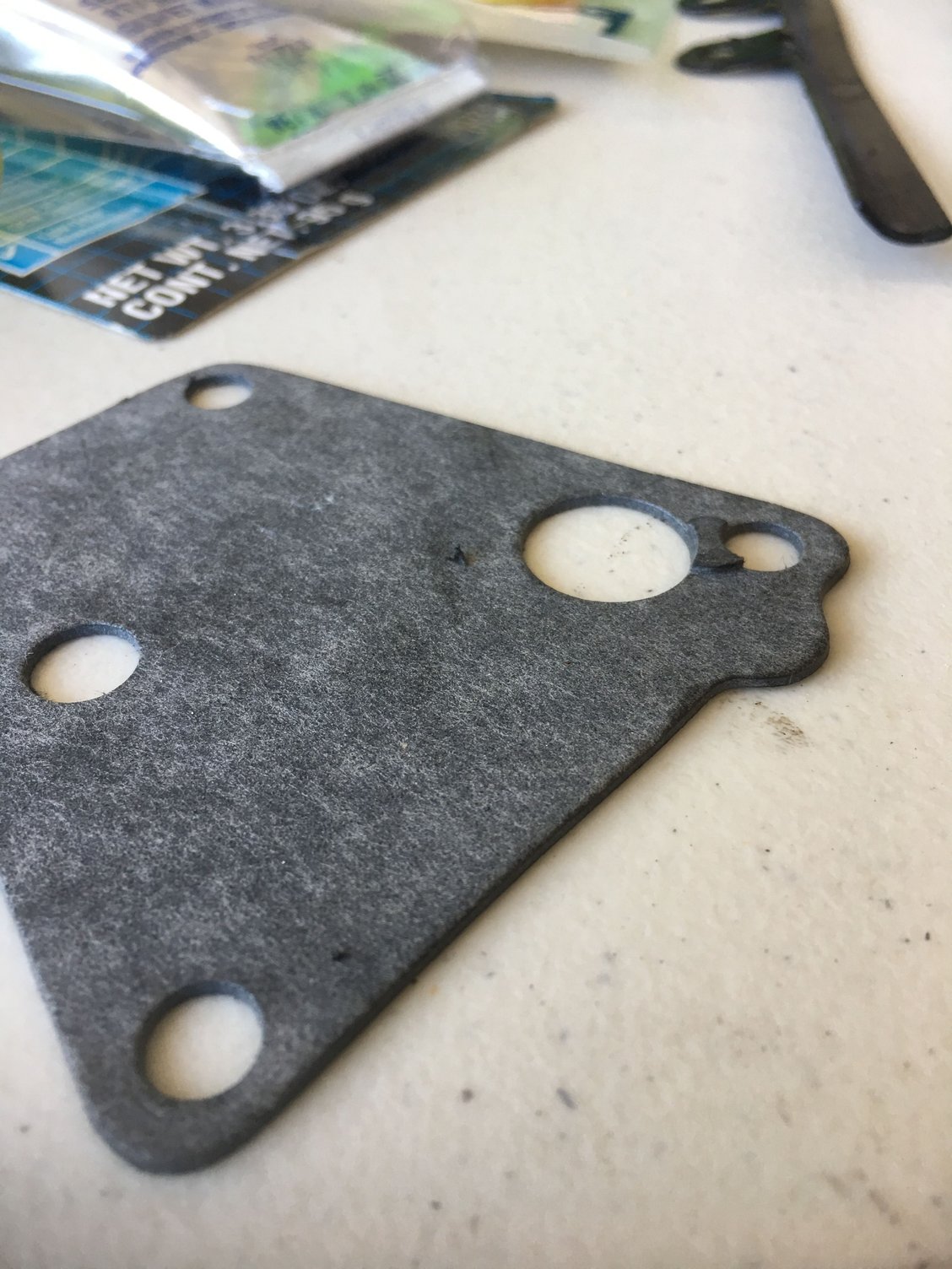

Ok, throttle body off and yep, the heater gasket had issues. I have a replacement Britpart gasket but it has an extra nubin on it that doesn’t look like it should be there. Is this a bad gasket or am I missing something?
