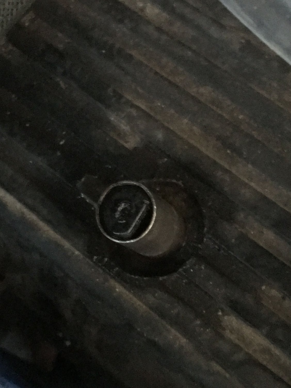

Do you see what I see?
Old Feb 21, 2019 | 09:07 PM
  #25
NVRover's Avatar
Joined: Aug 2018
Posts: 55
From: Boise, ID
So the oil separator was in upside down. It popped right out. I cleaned it and the whole assembly from the ram housing to the valve cover and re-assembled. That hose is in great shape. The driver’s side hose will be replaced soon, it is really soft, spongy even.
