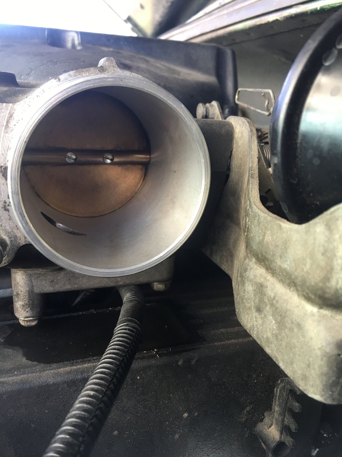

Is the old gasket on upside down? It looks like the holes don’t line up correctly.

Before cleaning and h2o jacket replacement
Pretty clean
A bit more grubby
Clean, new gasket and plate and ready to go back in

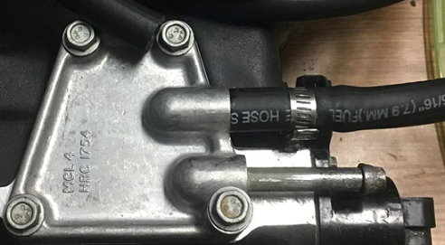

Just a heads up, you don't want to use Fuel Hose for the TBH Plate.
The coolant will eat that hose from the inside ( and yes I've made this mistake) providing you with your next leak.
Grab some 5/16" hose from Napa that is rated for coolant.
Or IMHO it's 5/16" Silicone Hose (and proper clamps) or nothing.
But Fuel hose = in the near future.
Good Luck!

Thanks for the heads up. I will switch it out prior to reseating it. I tend to fumble through this and learn as I go. I’m always open to tips and lessons learned. ��

Ok, out of the APCs and back to the Rover. The throttle body is back in place and curing the rtv. The heater lines are upgraded and now I am just waiting for tomorrow to replace exhaust manifold gaskets. Hopefully that pesky coolant leak and tapping are in the past.
