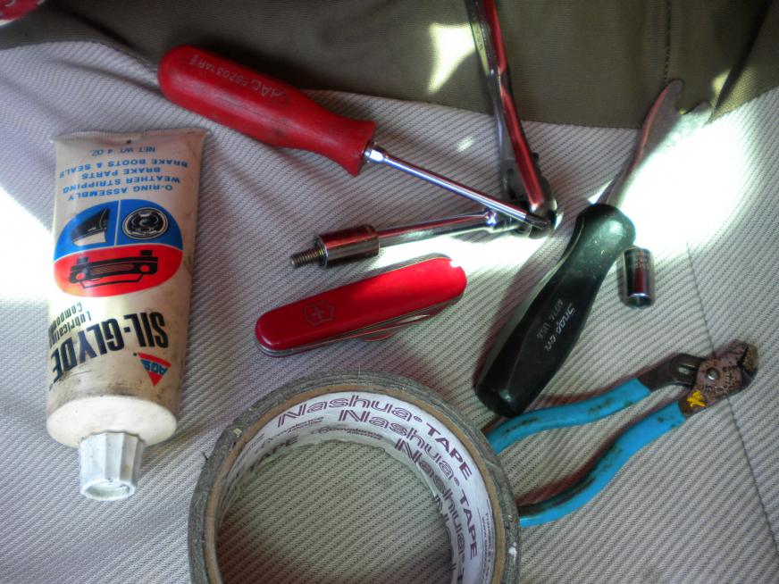

pic attached is of the tools needed LESS-pan to boil in and tongs
when you boil the washers.....it may not SNAP on the 1st time a couple took 3-4-5 times ...if they don't go on.,...dunk back in pot and keep boiling...

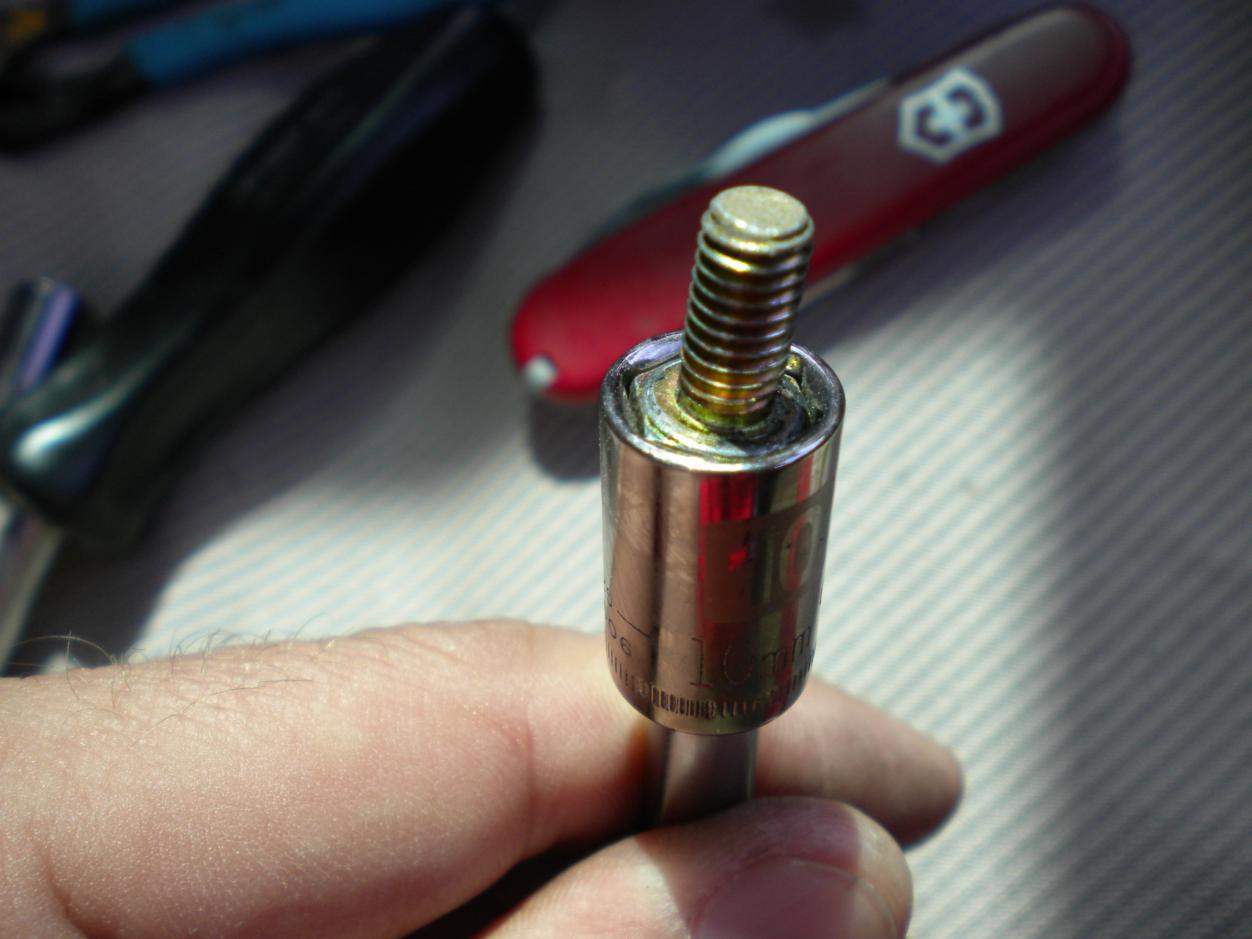

ANOTHER TIP : on the 10mm socket to take door handle/grip on....stuff some paper or tape in there so more threads stick out of socket

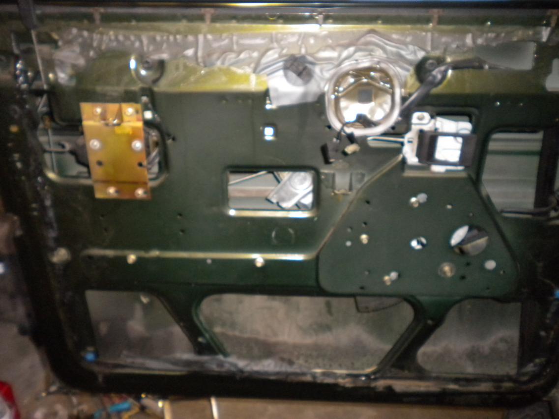

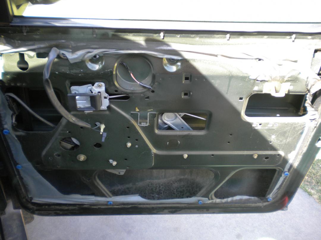

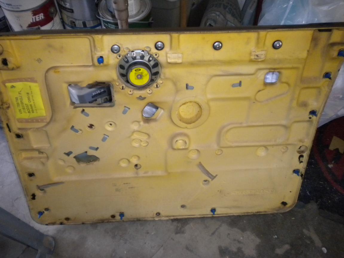

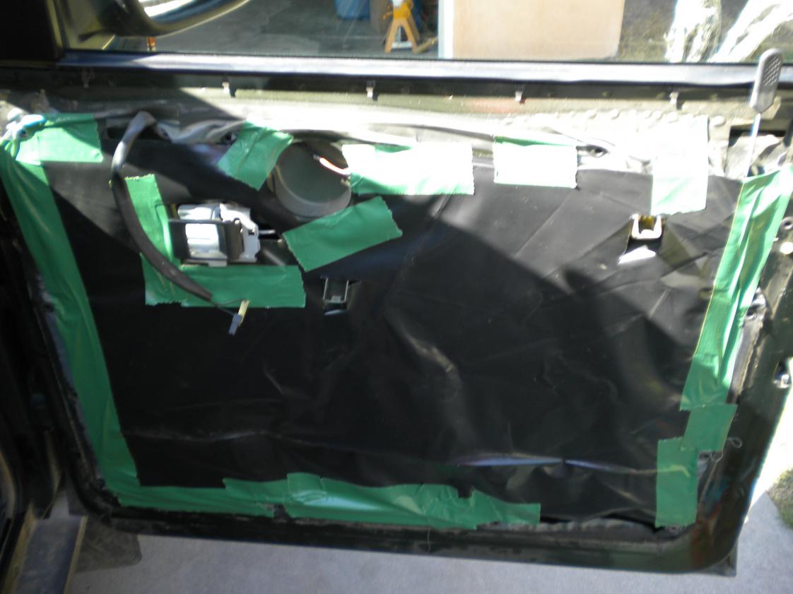

Front driver side door.................
Inside view of door under panel
inside on door panel

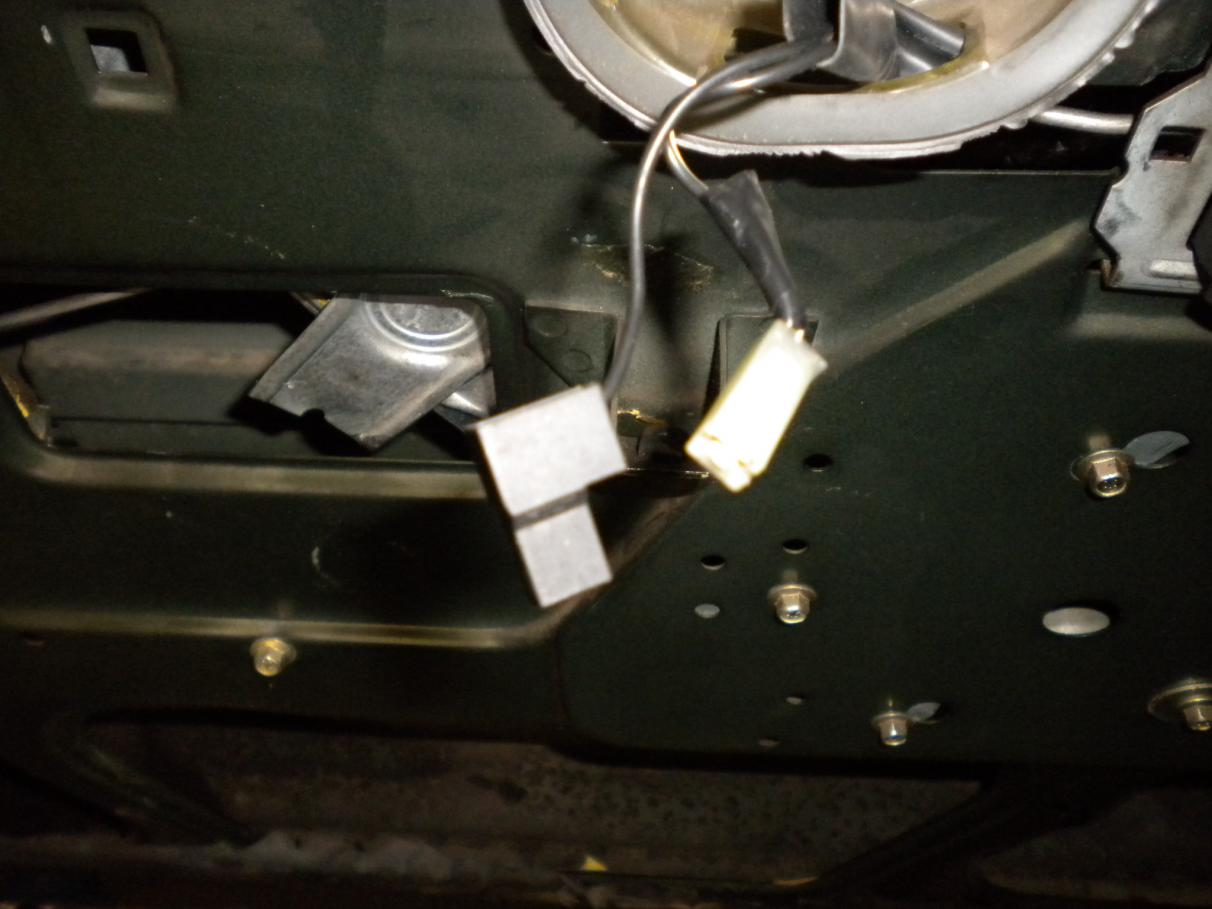

speaker wires that need to be disconnected

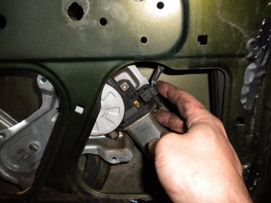

wire that needs to be disconnected from window regulator

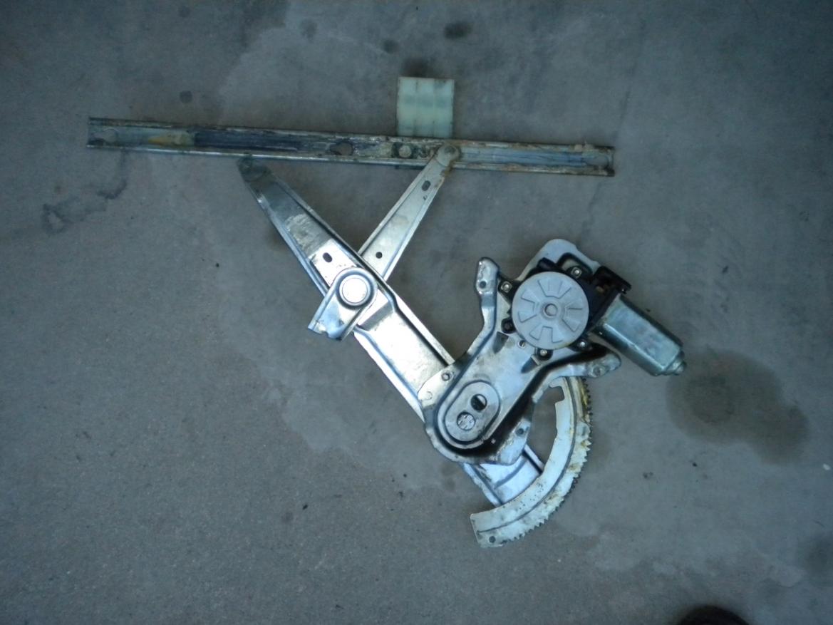

window regulator out NOTE MINE HAS BEEN DAMAGED AND CUT BY PREVIOUS OWNER.........(i had to make a arm and end from a 2000 model ugg then weld on..........WORKS)

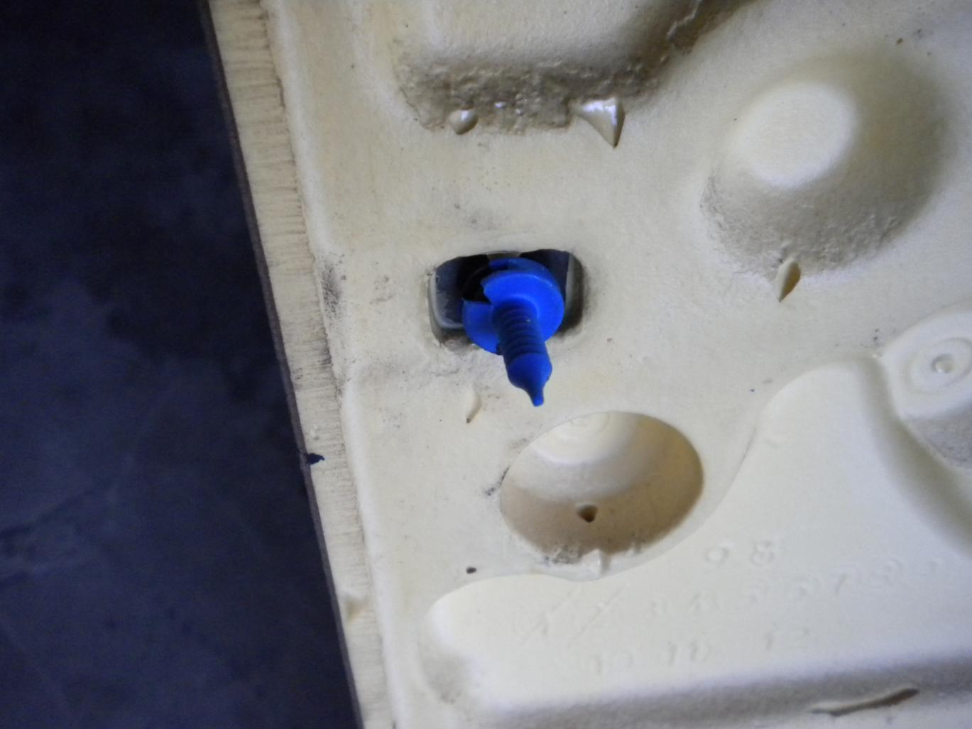

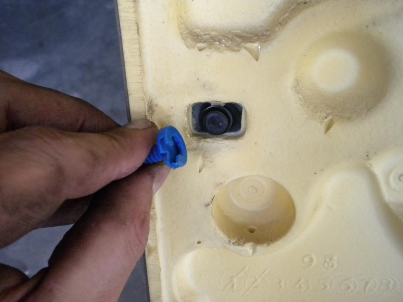

passenger side front door
before....
after with plastic in....
again when i opened panal to grease window rails/guides.... the plastic was gone and on this side SO WAS MY DOOR LOCK ACTUATOR i hoped it would just be a wire...NOPE....LOLOLOL

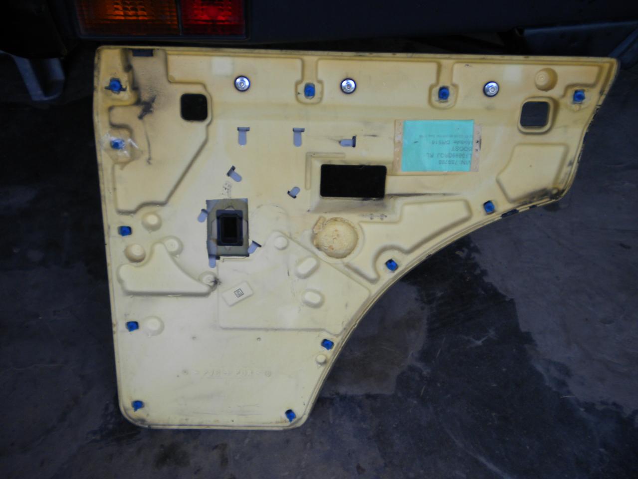

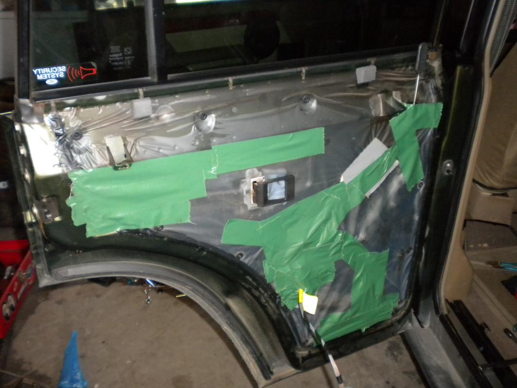

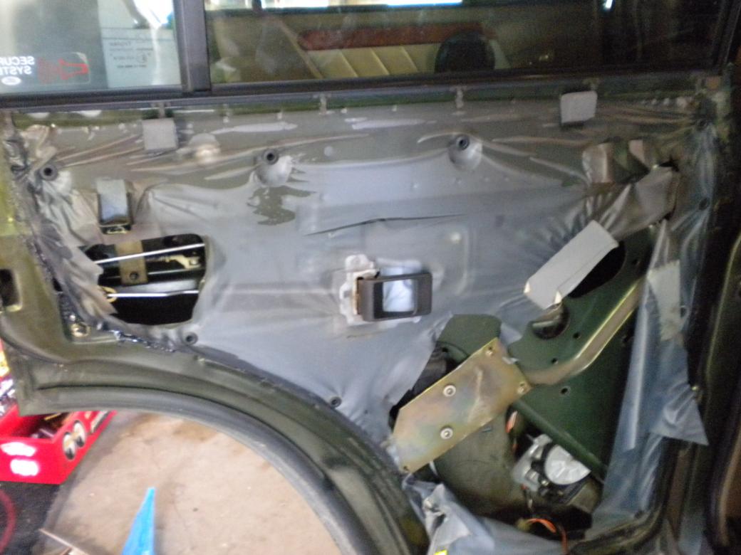

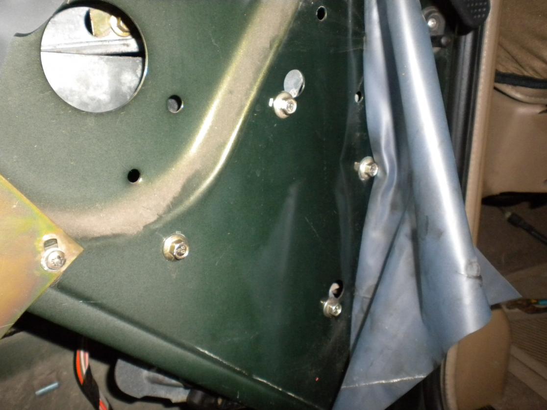

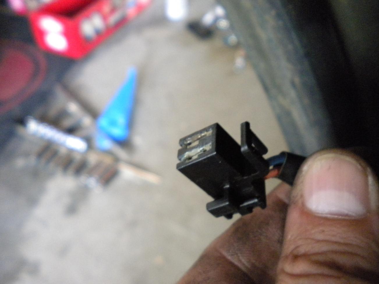

REAR DOOR these pics are all of the DRIVER side(left)
remove the 2 10mm bolts from handle
remove phillips screw from handle...slide plactic handle trim out....
inside of door/panel removed......(hey it had plastic WOOHOO no monkey business)

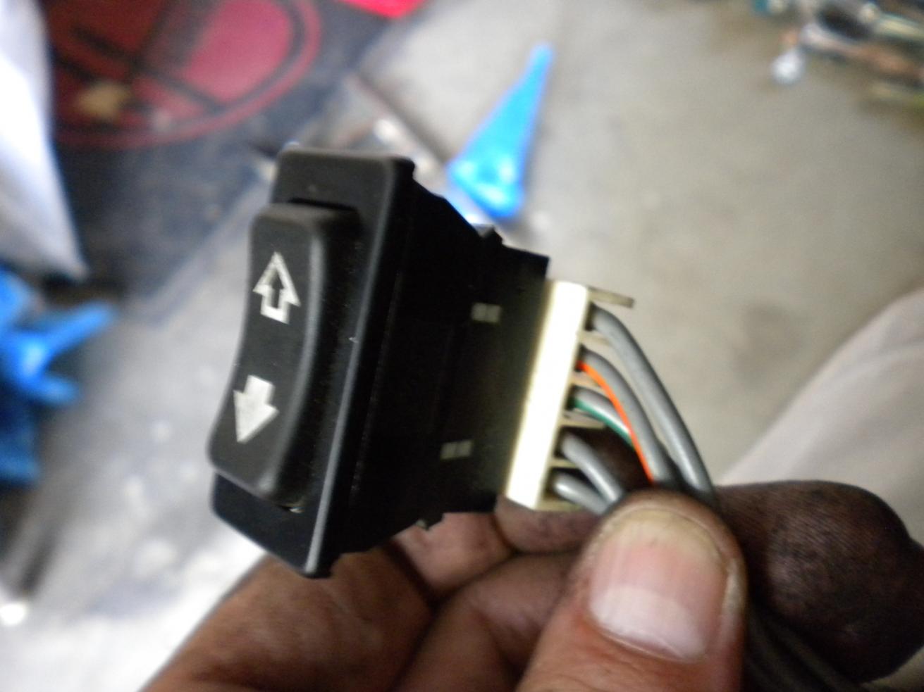

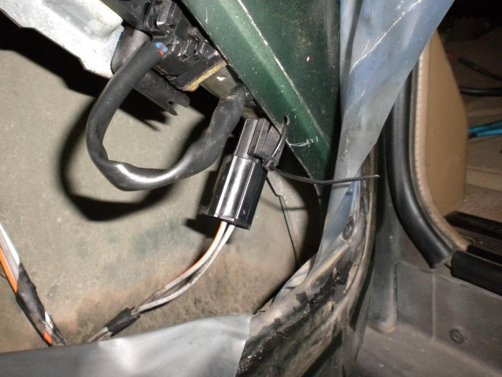

remove the DOOR window reg switch harness.....
cut the zip tie from window reg harness......
mark around bolts with sharp awl.....remove the 4 8mm bolts that hold window reg on to door......
Drop reg. down so you can remove the power wire harness off window reg.
i used my SWISS ARMY KNIFE to pry under clip retainer then just tug it will pop off.......

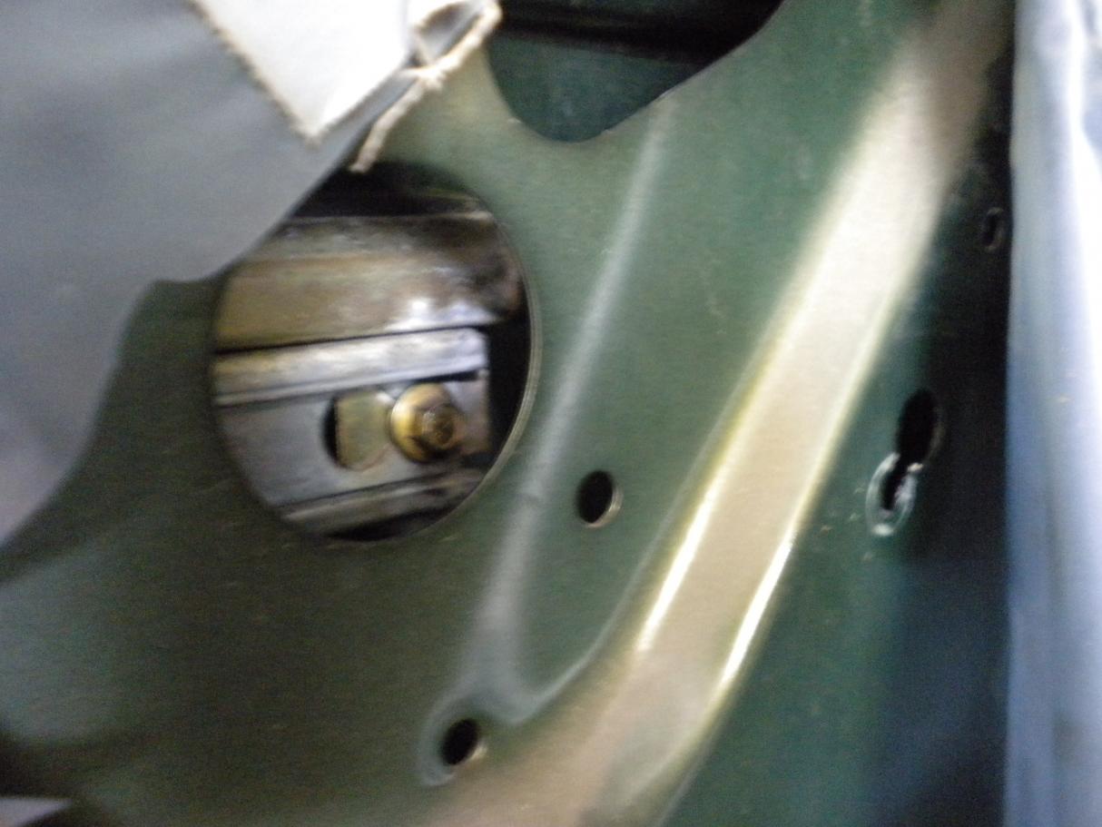

then i took bolt out of one side of the RAIL the washers ride in.......
to get the original out and the NEW in.....i had to pry the ends of RAIL out....they were PINCHED at top and bottom at ends...i used a SMALL pair of channel locks....worked like a champ ..and did this still bolted in the door!!!!
once pryed out ends....slide the old off rail......
BOIL NEW...INSTALL ON REGULATOR ARM
slide on add the bolt back in rail end...pinch end if ya want...bolt stops it anywho........
