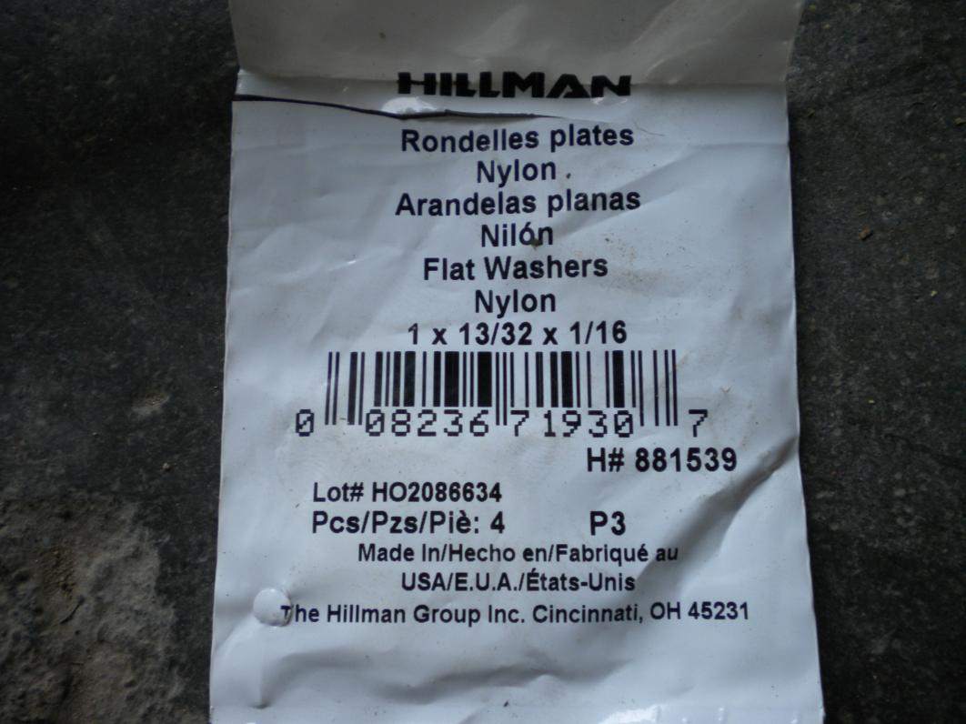

Ill take a picture of the nylon washers tomorrow. They come 6 or 8 to a bag. I used two on each track. 3 years and still holding strong.

I just so happen to have a regulator with the nylon washers on it. I also have some nylon washers in the packaging. Ill take some pics tomorrow.

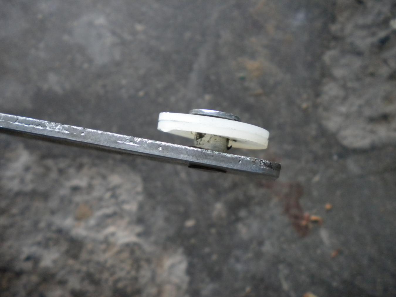

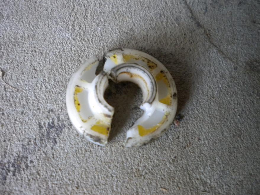

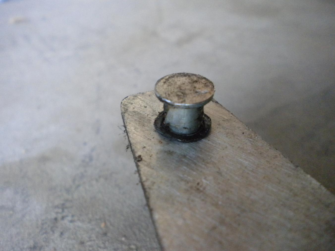

sorry 1st time tryin to post pix.....HOPE THIS WORKS......
Attached Thumbnails Window Regulator Bushing Repair(alternative method)-rover-repair-knives-mix-015.jpg   Window Regulator Bushing Repair(alternative method)-rover-repair-knives-mix-011.jpg   Window Regulator Bushing Repair(alternative method)-rover-repair-knives-mix-010.jpg   Window Regulator Bushing Repair(alternative method)-rover-repair-knives-mix-014.jpg

HA!!! IT WORKED!!!! WOO HOO.....ok i took a bunch of pix of whole process front and back(i think??) heheh...... lemme know if any are needed.............JUNEBUG
