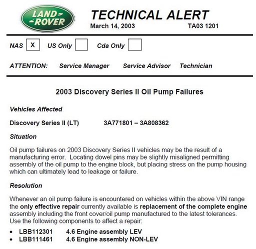

Vin range falls within the TSB for Oil pump failure...(see attached image)
There is a risk if the engine is the original one that the pump can go anytime but at this mileage you may be safe for a good while. What do you plan to use it for? Remember....
  • The front drive shaft MUST be rebuilt using greasable u-joints if it has not been rebuilt already or it'll punch a hole in you tranny
  • They require premium gas (not an option)
  • Read over Disco-Mike's 60 mile service an plan to get caught up with whatever the previous 2 owners neglected to do.
  • Head gaskets may be leaking if not already.
  • The 2003 DII doesn't have CDL (Lock the transfer case) so if you are planning to take if off road you will be limited in traction ability.
I bought an SE with 57k for 8k back in Sep 2008 so I think you can ask for less.
Good luck!

Since it's in the VIN range, as metioned, I would say bad idea. Try to find another one that not in the "problem zone". Also, you can find cheaper! Do alot of research, you'll find alot of well priced discos. Dont be afraid to search a state over, sometimes thats how you can find the best deals, and it will be worth the drive.
