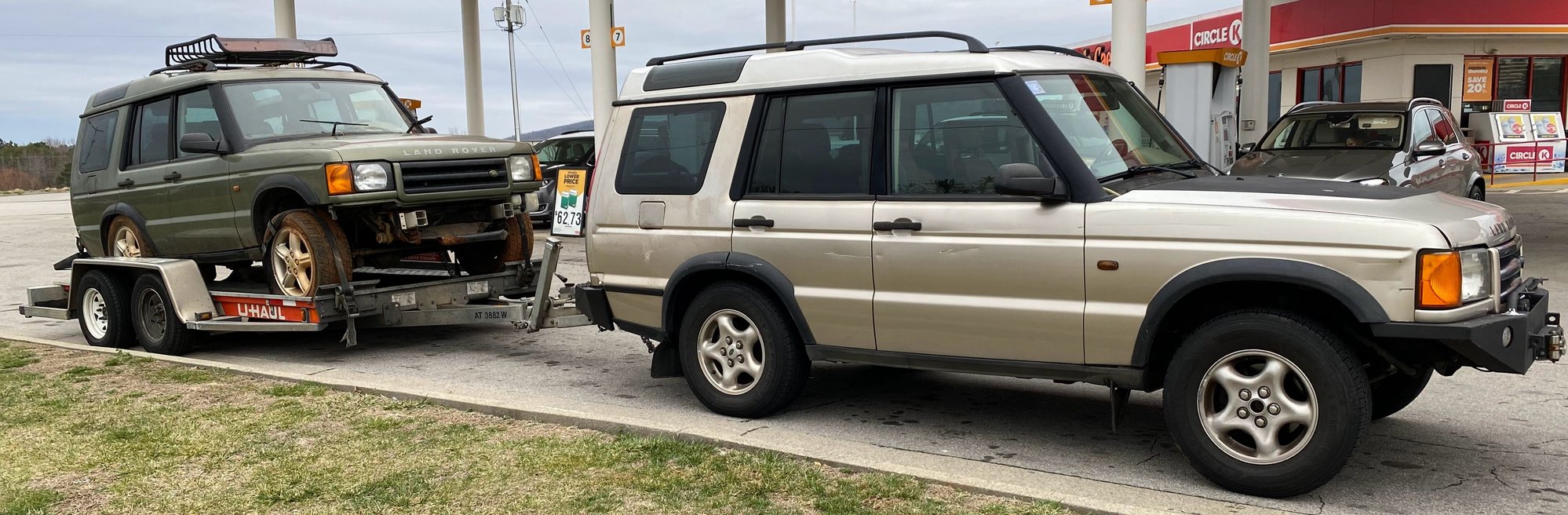

There was a similar thread a while back. I have pulled Discos with Discos, so probably 7000 lbs over mountain passes. Not the fastest tow vehicle but it will get the job done. Did have to stop halfway up and let it cool off, though, so keep that in mind.

I towed with my disco a ton back when I was dailying it. I've had more than 8000# behind my '03. That was with a hopped up 4.6. I did run trailer brakes (usually...) and dual transmission coolers to keep everything happy.
All in all, far from the best tow rig, but it'll get the job done if you take it slow. Highly recommend a secondary trans cooler, but looks like you've covered yourself other than that.
