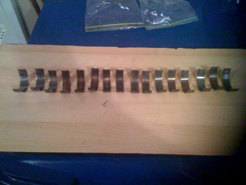

Ok here are pictures of the rod bearings. Pretty interesting the way they look from back to front. 8/7 are on the left and count down to #1 all the way on the right. Far left is really thin and no copper there at all. 6/5/4 are showing mostly copper and 3/2/1 are only showing a little copper
Attached Thumbnails 03 4.6 any way to identify/prevent slipper liners?-all-bearings.jpg

here are the crank journals. it looks like the bearing is still clamped on but its not. the most worn was #8. With the pan off this is why there was soooo much play in the rod. Other pic is of journals for 1/2 and 3/4 which seem ok. Just want to put this out there for anyone else who has an 03/04 4.6 with noise. Everything I read said these motors only make noise when a liner slips. So i took engine apart prepared to install top hat liners. Liners don't seem to have slipped at all and here you can see the shape of the bearings and crank. Its not too bad to pull the pan off so I would recommend that as a first step. I would also recommend installing an oil pressue gauge I am definitely doing that as I reinstall this motor for obvious reasons.
Attached Thumbnails 03 4.6 any way to identify/prevent slipper liners?-worn-journals.jpg   03 4.6 any way to identify/prevent slipper liners?-good-journals.jpg
