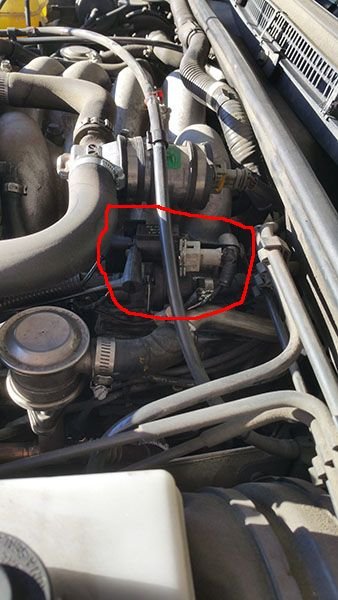

I thought this was an electrical piece, but it changes the RPM if starting fluid is sprayed on it.
Any idea what is under there that would change the RPM when sprayed? It's the open space behind the alternator, and under the hoses/cables.

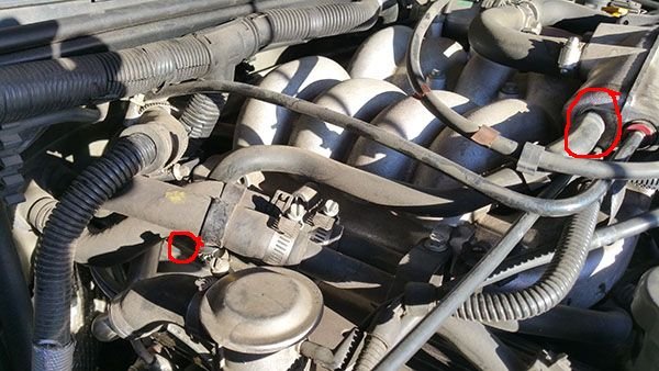

Can anyone please tell me the name of this hose? It seems to change the RPM if I spray the fluid at either end. Would like to replace the hose, just not sure what it's called.

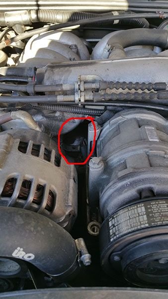

This one is kind of puzzling to me as well - this is a bundle of electrical wires inside the split loom, right? But, if I spray it, the RPM definitely goes up. Is there maybe something underneath or behind the wires there that is a common culprit for a leak?

OK, Thanks! I'll try to figure out where those leaks are coming from. By any chance do you know the name of that hose I have circled both ends in red? I'd like to order a new one. Not sure what to think about those electrical areas, but there must be a hose in or around those areas too...have to dig into it when I have some time in the daylight.

The first pic was your evap purge valve, the second between the alternator and a/c compressor is you coolant temp sensor, the third off the manifold going to the rocker cover is your breather tube that has an oil seperator in the valve cove and the wiring loom has no vacuum lines that I know of. Just the coil pack. The only conclusion I could think of would be the secondary air injection being loose somewhere and and it being like shooting ether into a carb. But that's just my 2 cents worth. There are more vacuum lines with secondary air

The breather hose that connects the Bank 2 valve cover to the intake fits on a plastic fitting at the intake end. You might check to see if the fitting is cracked or broken. If it is you can replace it for a few bucks with a brass version available in the plumbing section at your local Lowe's, Home Depot, etc.
