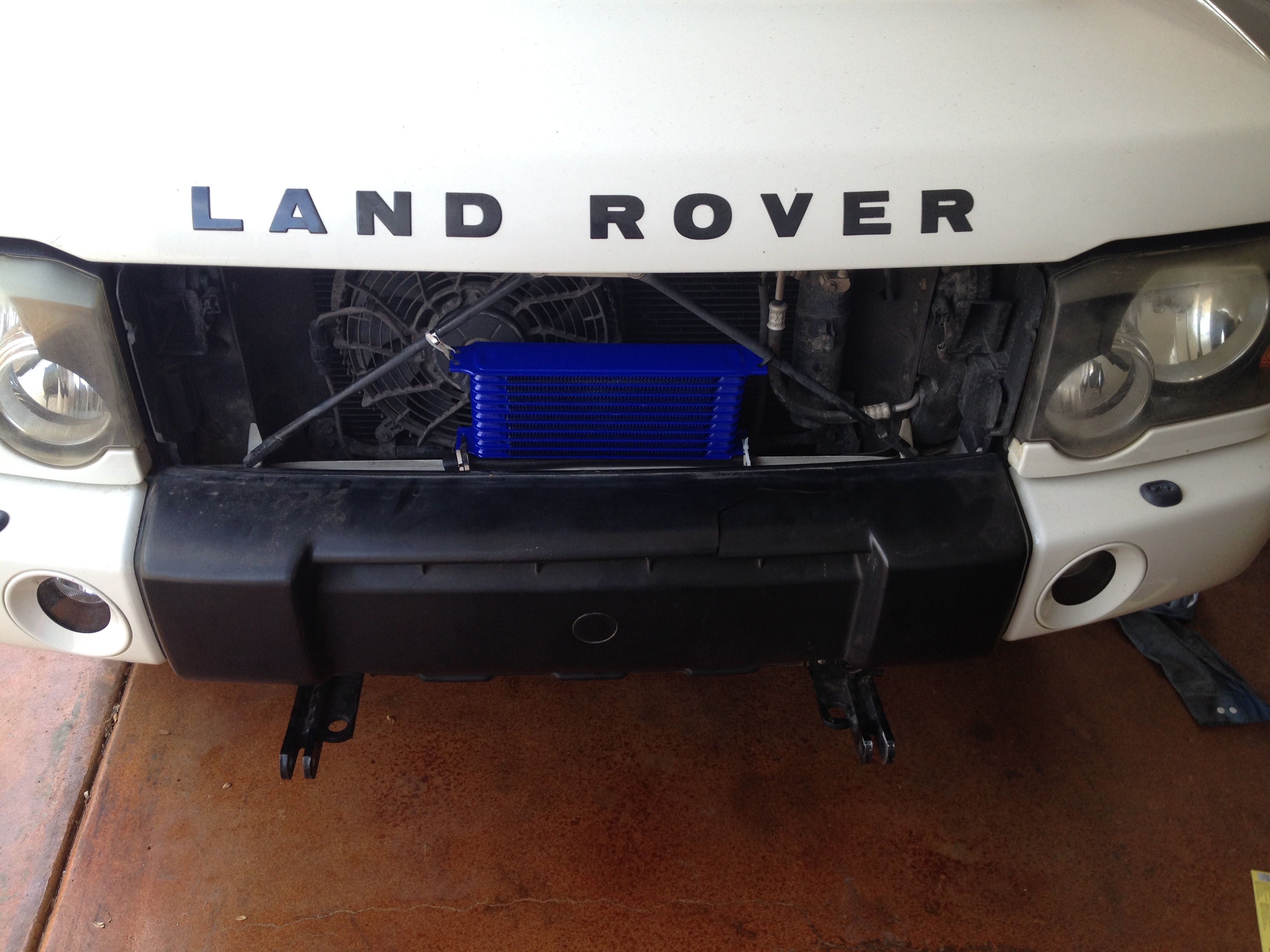

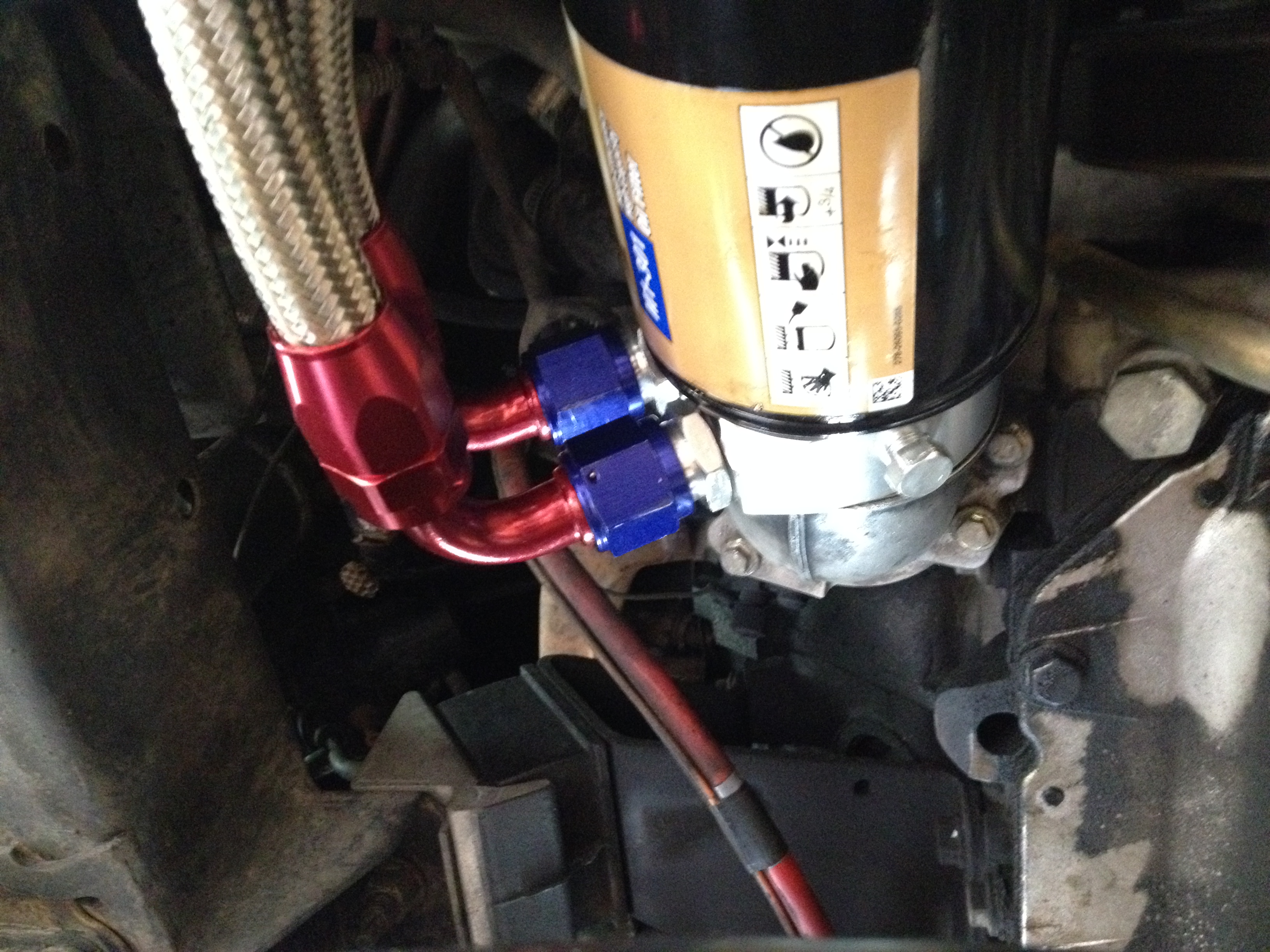

Pics attached.
Used SS zip ties and plastic as backup. Padded cross brace with a scrap piece of fuel line.
Easy install. Highly recommend.'03 Disco II add/upgrade Oil Cooler-photo-sep-01-13-16-21.jpg
