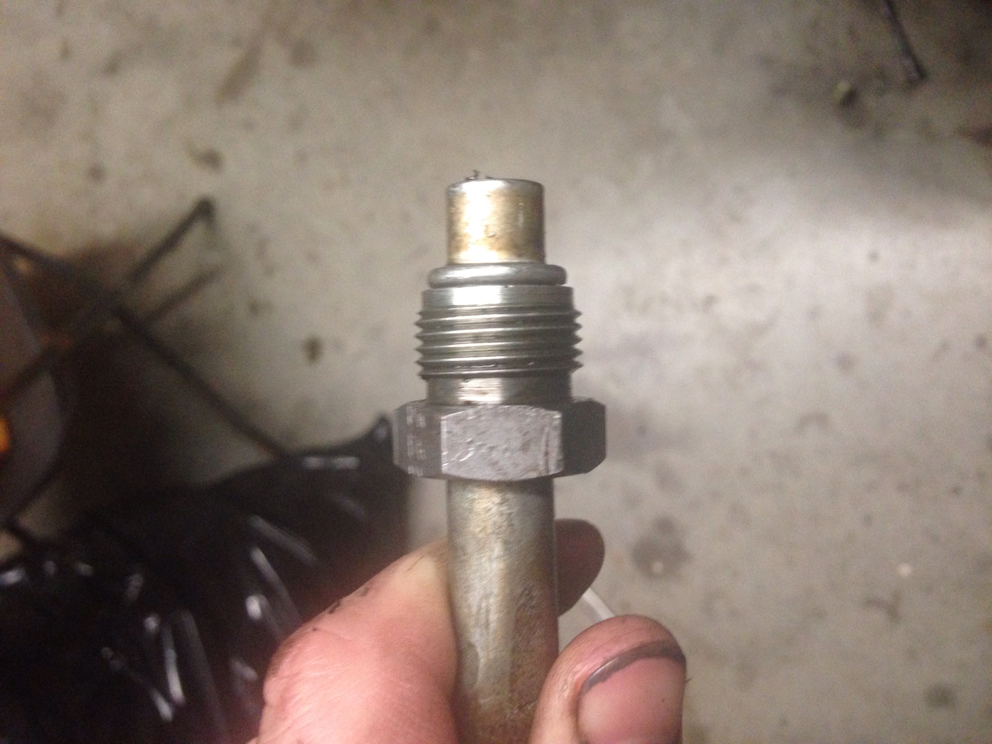

Driver side pipe. If this is where it even goes

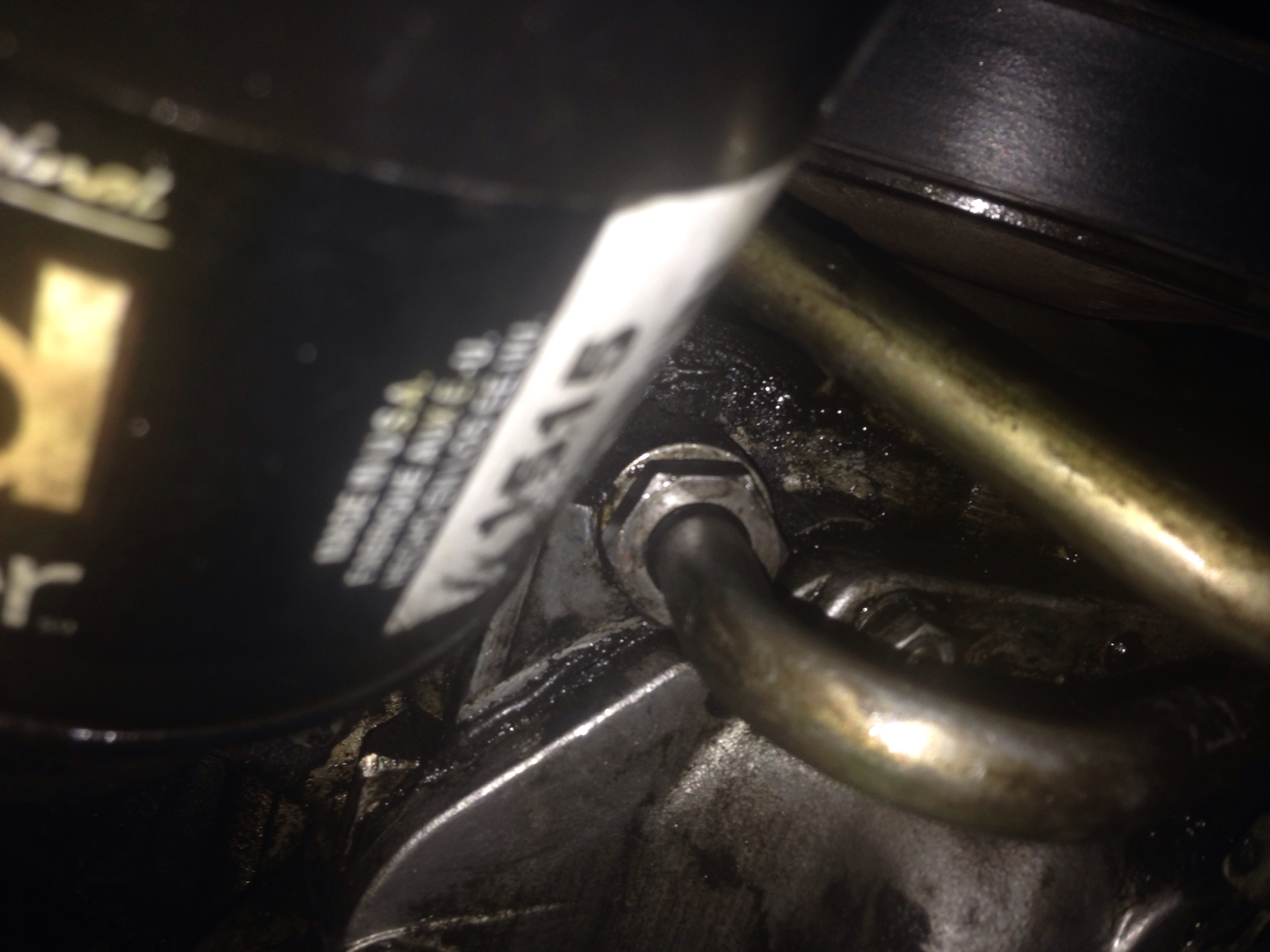

This is where I was trying to go with the pass side pipe. But it wouldn't go in there

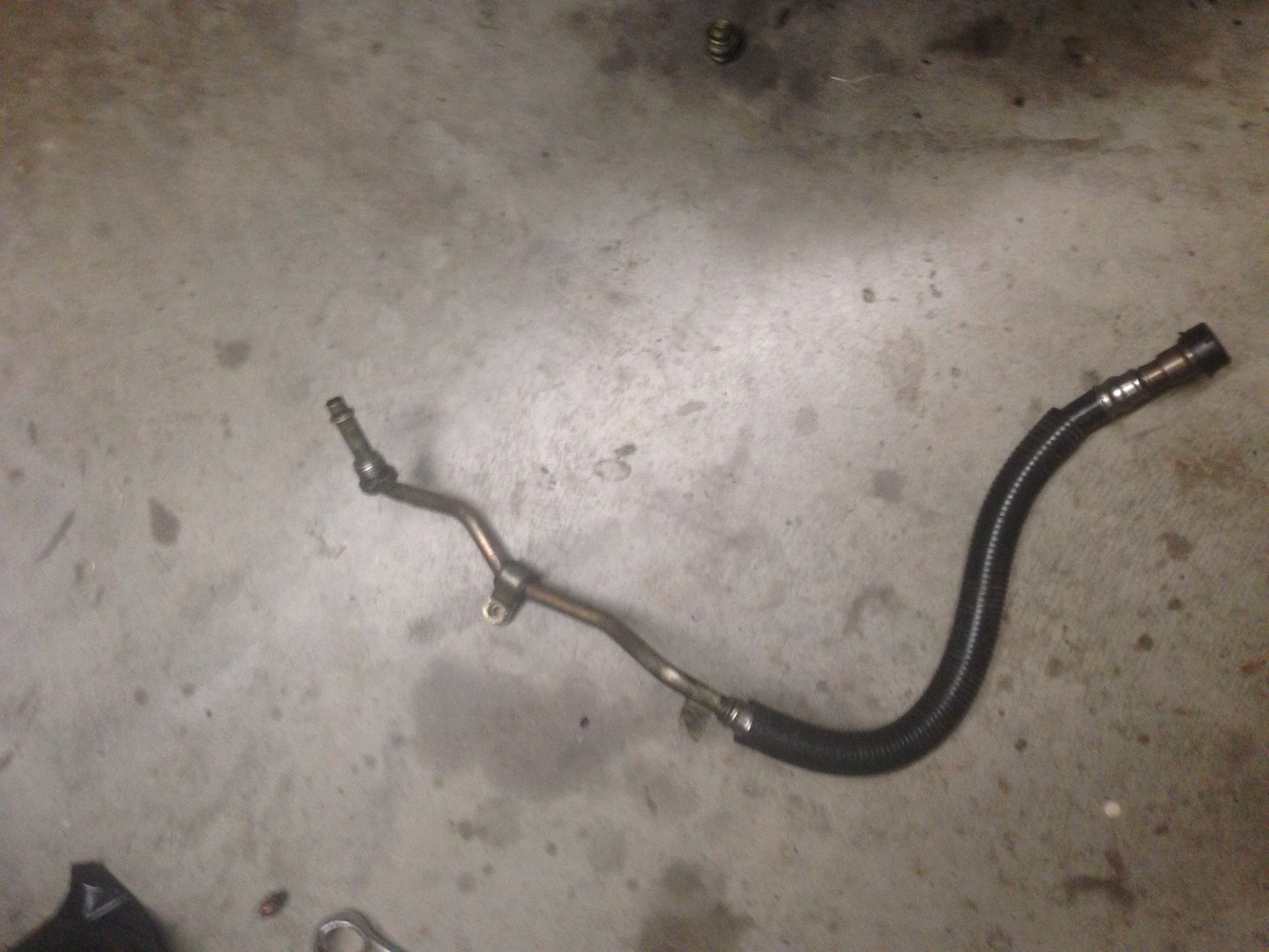

The end of the pass side pipe. Good condition but felt like it wasn't going in far enough on that port up and behind the oil filter. I did get it to thread in on the same port that I originally had the driver side pipe plugged in to down at the very bottom of the cover so it's not the pipe

Pipe I tried to run on pass side. Tight of fit as it may be, it sure seemed like I had each pipe in its respective location. I had to tweak that one on the driver side a few times to get it JUST right, but the other side wasn't goin to take it.

From memory the driver side of the one with the hard line that has the most drastic bend and to fits in the 6 o clock port.
The other one is the pass side. If I recall there are two plugs on that side that could take it, but maybe not.
I install each one on the front cover first, then army teach the push connectors on the cooler.

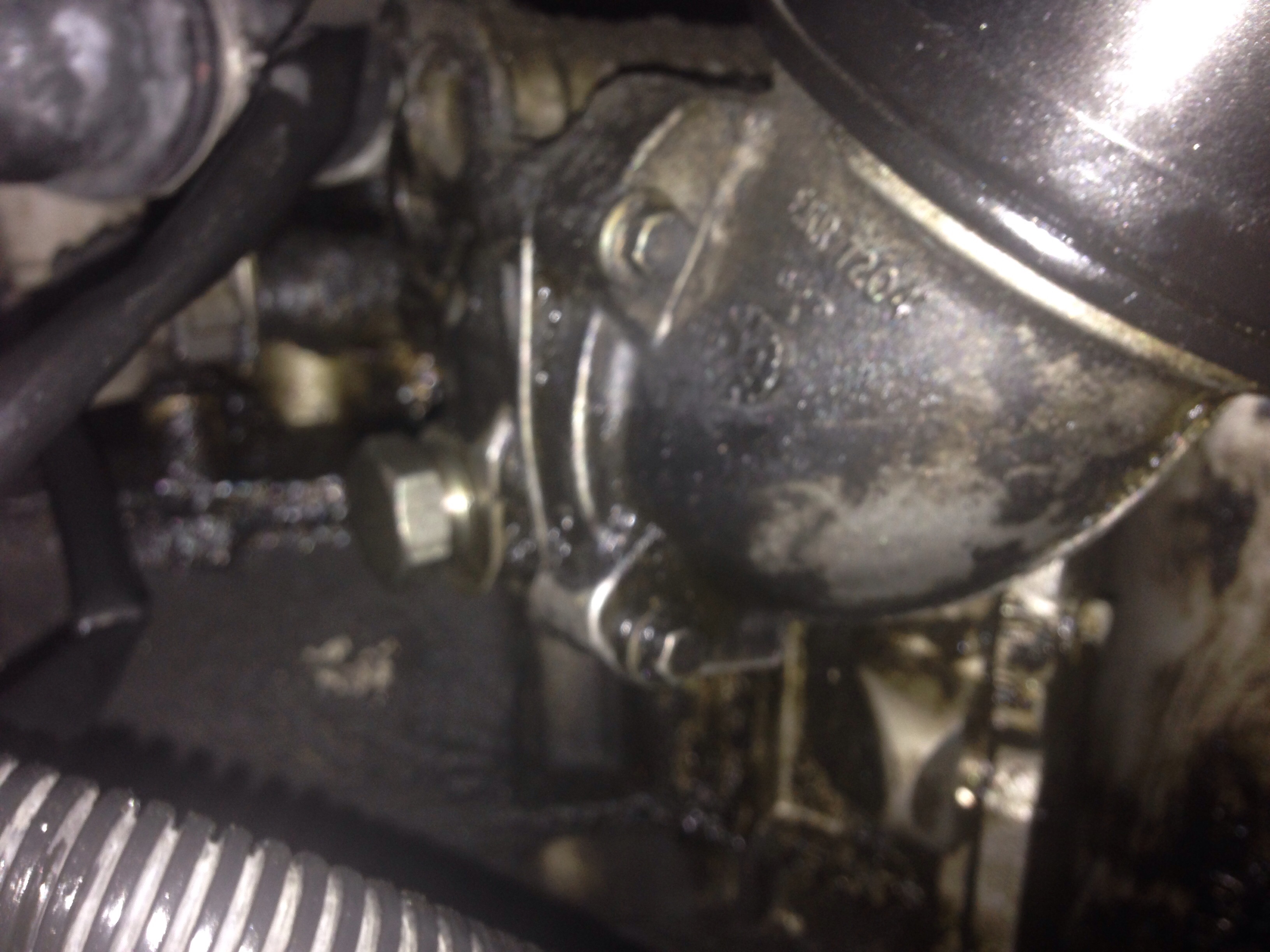

Old Apr 19, 2016 | 12:18 AM
  #70
chubbs878's Avatar
Posts: 1,387
Likes: 111
From: Dallas, TX
Originally Posted by abran
Sorry, all my pics got lost with last phone.
Have you searched RAVE for images?
So you think the port to the right (more toward front of vehicle) that has cap instead of bolt serves the same purpose? Anybody?
