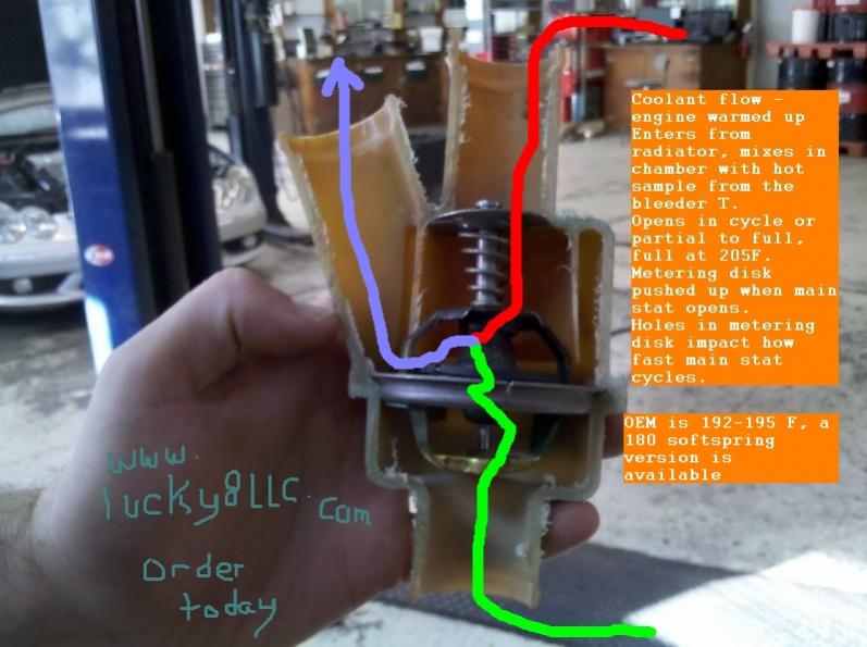

Not sure how vehicle could operate with hose missing from thermostat. You would have massive coolant loss. Here is a cutaway drawing, cold water comes in the bottom, hot sample comes in the top to trigger the thermostat to open, and flow goes out the side arm to the water pump.
Attached Thumbnails 04 Discovery Stalled, now turns over but no start-img_20111102_151054d.jpg   04 Discovery Stalled, now turns over but no start-d2-coolant-flow-001.jpg

Thanks for all the help guys. I'm taking the battery in to get tested right now. I reconnected the coolant lines & filled it up. It was completely empty. It might be the CAS, I replaced it once already at 50,000 miles but who knows. I'll test it again and see what happens. Hopefully it just starts right up with a new battery.
