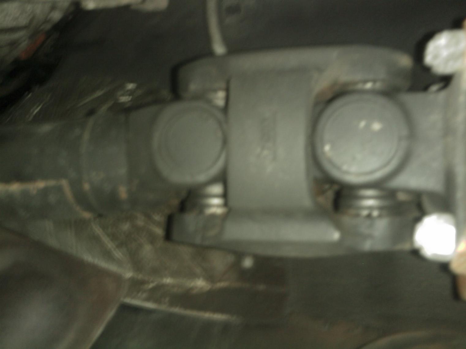

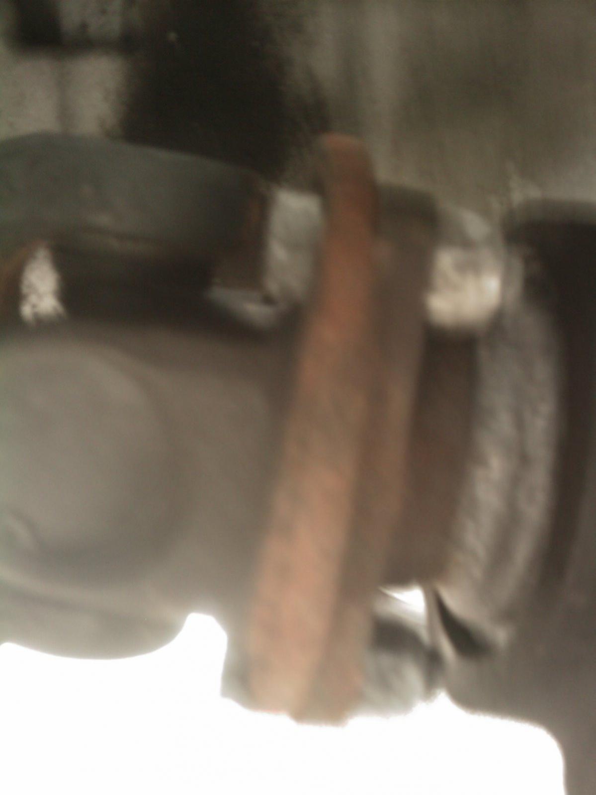

Okay I took some pictures, of the front of the driveshaft. It appears to be New-er but Im no mechanic so you guys tell me what you think. I tried to get a couple quick videos, one of the drive shaft for a couple seconds, and then one of the belt making the squeak squeak as it rotates, but the video doesnt really allot you to hear much of it.
Images are attached. The squeak very clearly comes from the pullys. I think were going to order the new belt, and then the new tensioner pullys also. If he has to take it apart might as well kill to birds with one stone. I also called the Vocational center in my area and am waiting for a response back. I let them no that I'm a kid from my community (Most kids attend Vocational there) and that I dont really have the money to pay a land rover dealer to do a complete flush of the fluids in the vehicle, however, I would be interested in having him use my car as a demonstration on how to do things. (If you let the voc teacher work on your car, its free, you only pay for parts.) Might not be perfect like a dealer could do, but when your younger, 100 dollars is 100 dollars.)

The part of the driveshaft that breaks is the part that connects to the transfer case.
That big ugly looking thing is called a double cardon joint, two u-joints in one housing.
It is heavy and when it lets loose it spanks the transmission and breaks the cast aluminum case just like tornados pics show.
You cannot tell how old something is just by looking at it.
When I was in High School we also did the VOC thing, did lots of work on my car for cheap.
Rebuilding the front driveshaft is priority number 1.
As for the rest piece of cake, if I can do it you guys can.

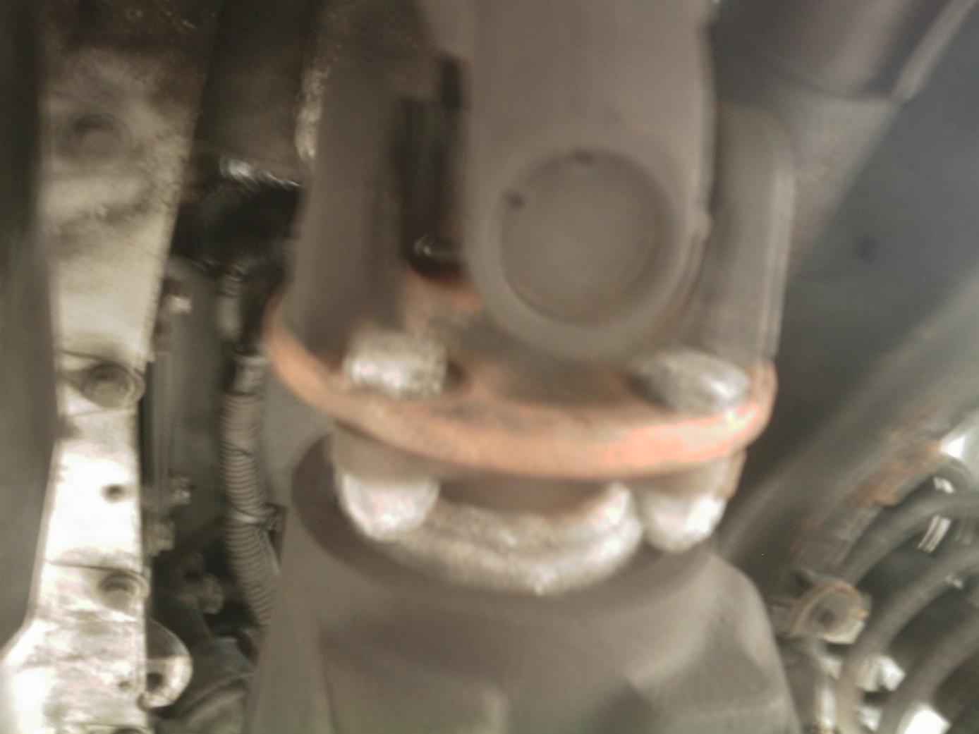

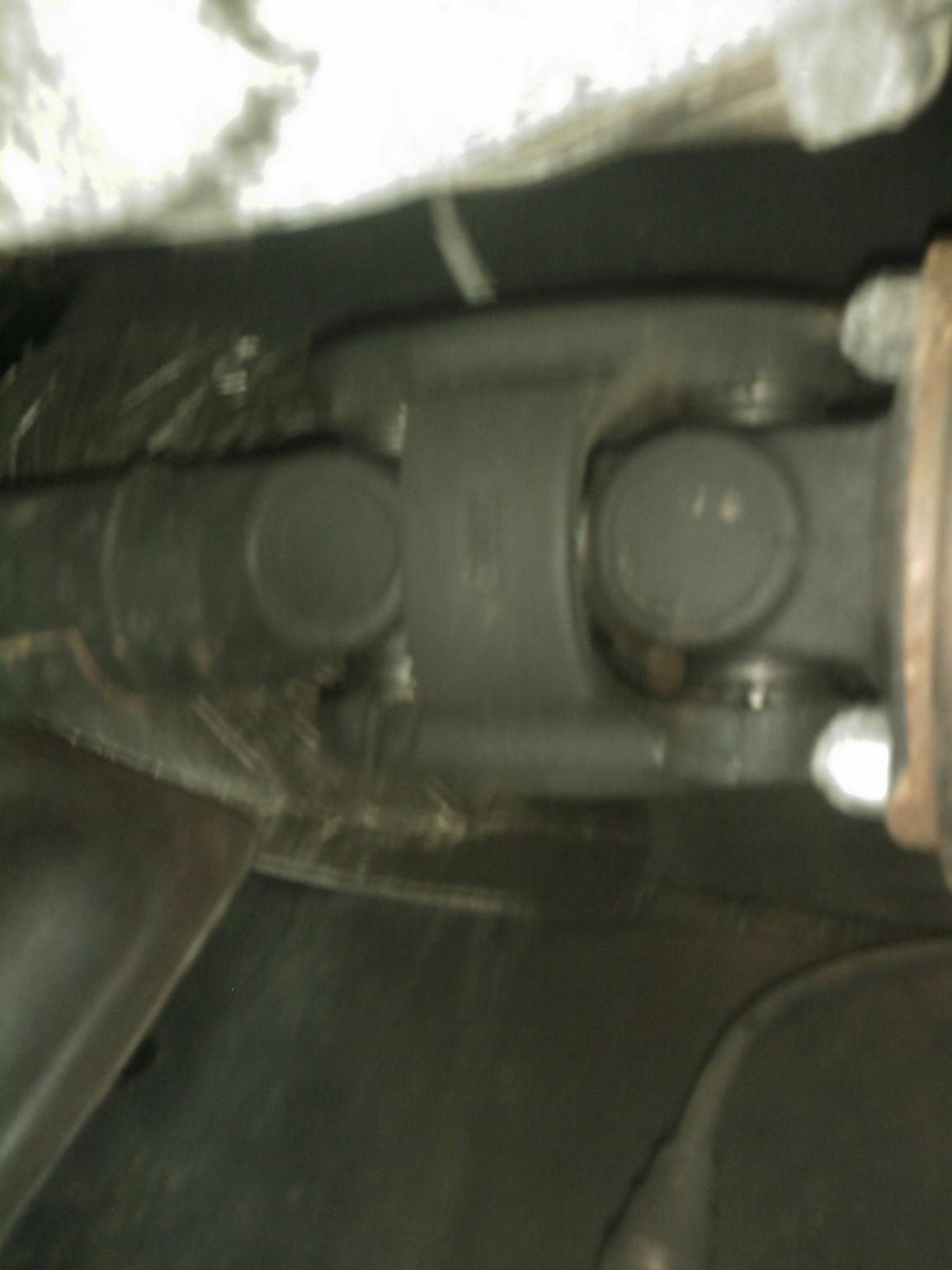

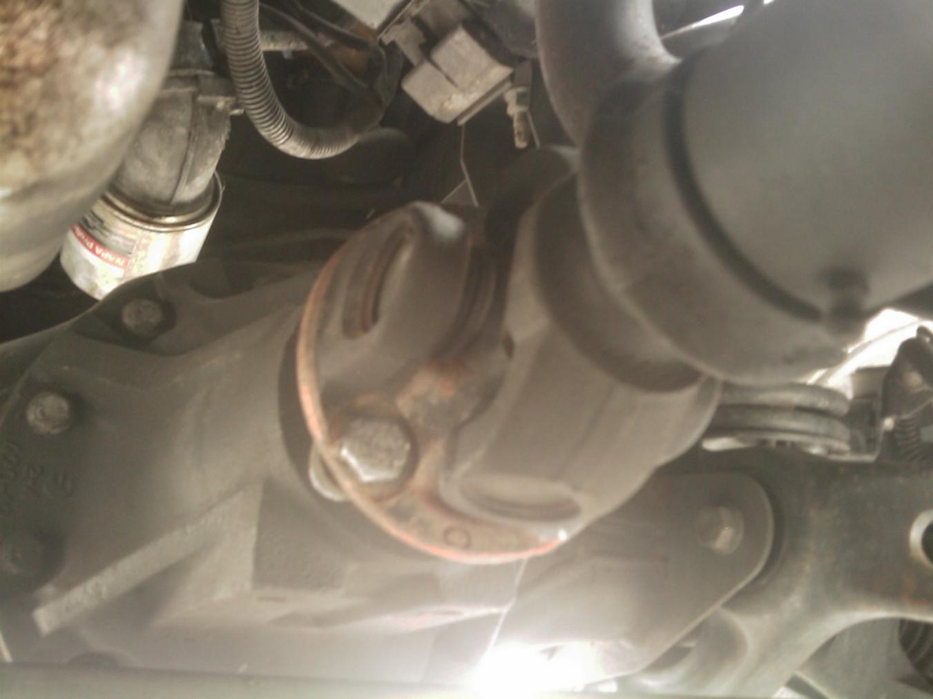

Okay so I took the picture of the wrong joint? Here is a second set of the joint a little bit further back than the first one. The first set of pictures were closer to the wide opening part of the transmission, and this one is closer to the more rectangular boxy part. What are the ways to tell weather it has u joint upgrade or not? The squeak is definetly not comming from the joint. I started the car and it idold and slow squeak I shined flash light down there and the driveshaft wasn't spinning ect, so the noise cannot be comming from there. Like you said the part cannot be determined by what it looks like, but they do appear to have a black paint shine to them, not rusty ect like some of the pics I have seen.
If I do NOT have the new u-joints do I need to order this whole thing
Here http://store.toddcosuspensions.com/larodiiifrdr.html
Or just this part
Here, and have the mechanic rebuild and install with the new u joints? http://www.partsgeek.com/gbproducts/...ek+Google+Base
Sorry if I sound dumb, Im not real good with cars, I know the basics and try my best to learn, but its not something that comes easy to me lol.

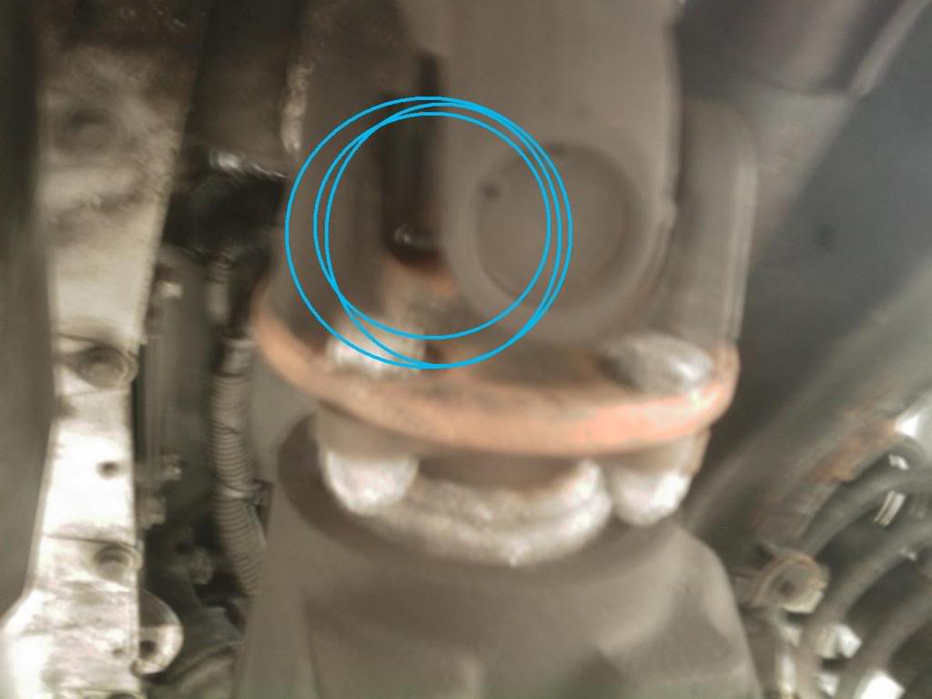

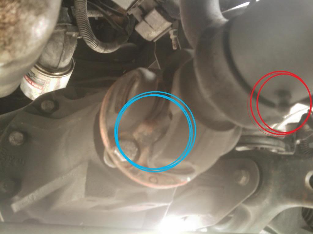

What you are looking for on the ujoints are "GREASE ZERTS" they are the nipples you inject grease..
One of you pictures shows one on the part of the shaft that lubricates the telescoping bit... Circled in Red... What you want to see is more of these on the U-Joints..Circled in Blue and Double Cardon joints on both sides of the drive shaft..
This might actually be one.. cant tell because of the quality of the Pictures..
If you have them.. Grease them and you should be golden.. If not.. have them rebuilt for $200 bucks or so and save yourself a VERY EXPENSIVE REPAIR..
You can learn how to do all this stuff, and believe me you will save yourelf a ton of money over the duration of your life if you take the opprotunity to learn how to work on vehicles now.. and the Disco is a good vehicle to learn on.
If you have grease zerts then make sure you clean them well before greasing them, and on the one that is on the telescoping bit.. you only need to put 4-6 squirts in it.. you dont want to over fill it and push out the rubber seal.. the rest of them just pump away untill fresh grease starts coming out all over the joint..

Look for grease zerts on the Double Cardon.. the part you just posted pics of..
If you dont have them, you can just unbolt the driveshaft and take the whole thing to a Shop that does Driveshafts and have them to the work..
Four Bolts on the front where the driveshaft connects to the front Differential and 4 bolts in the back where it connects to the transfer case
